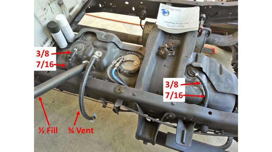

Joined: Jun 2009
Posts: 97
Your photo says 7/16. Did you mean 7/16?

It is 7/16 at those locations of the vent line. I had a hell of a time trying to get 3/8 to fit when my rear vent line disintegrated when I did my mod. I later found this pic saying it's 7/16 there. My 3/8 line is visible when I get in my rear fender well. So far its still securely attached but if it ever falls off, ill replace it with correct 7/16.
