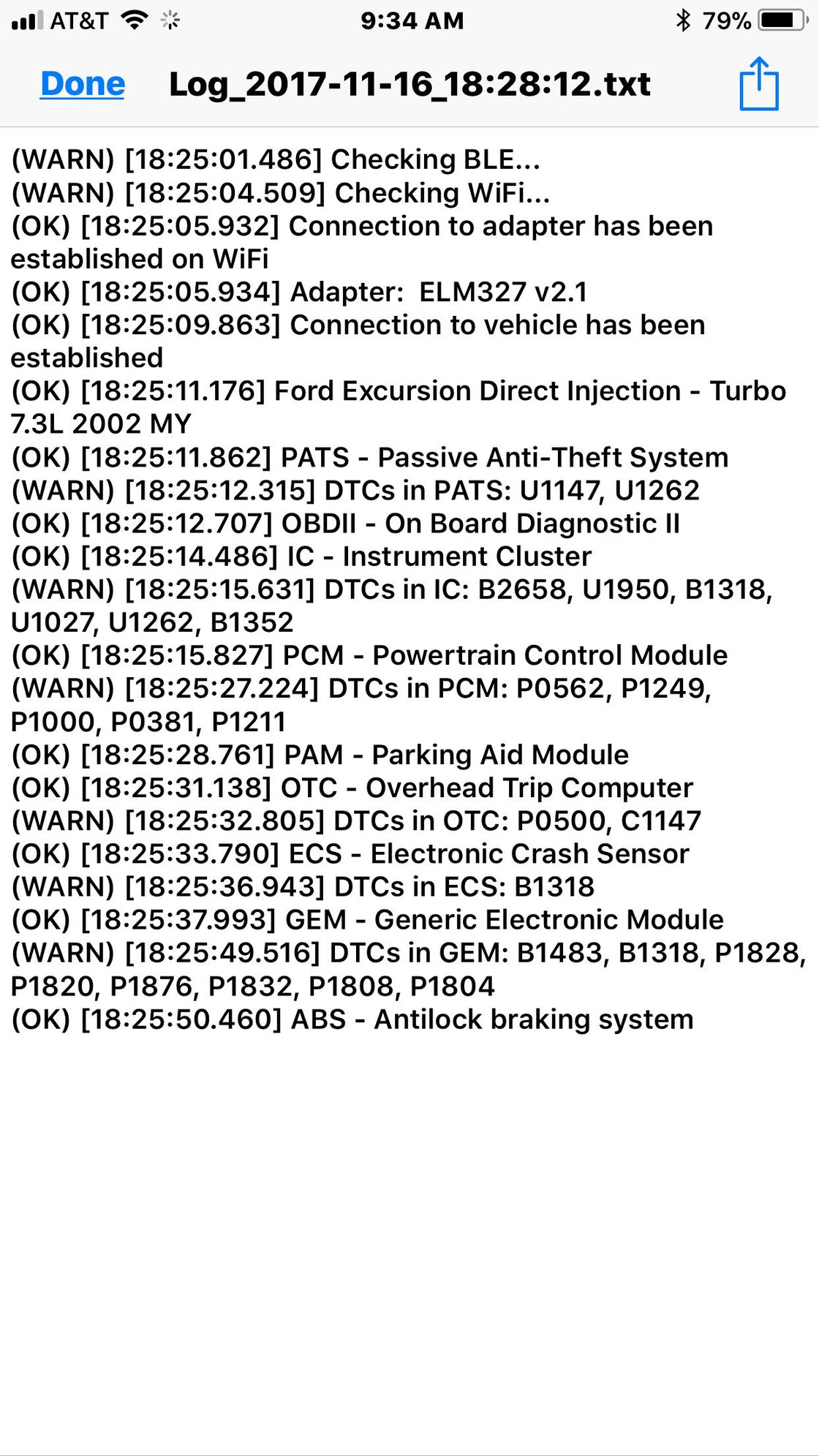

I have a log file that I will attempt to attach to this thread. If anyone can assist with that info may be telling me.

Good call on the Ford ICP sensor, the cheap fleabay items have a terrible rep. Especially when the complaint is "truck dies in same place all the time" first thing I think of is cheap ICP getting confused by strong RF emissions from a radio tower or similar.
If you can smoosh that log into a spreadsheet we can do some formatting. CSV file is ok too.
Normally the first step in diagnosis is indeed removing the chip, since bad connections there are often a problem. But in this case I'd try something else first. A common way an IPR fails is the solenoid works OK cold, and stops working when hot. So after the IPR gets hot enough the truck will stop running. Sounds like your situation. Evidently if you cool the IPR with a cup of ice or spray it with a "can of air" held upside down it will work again and allow the truck to start. Never tried it myself but it apparently works. Or borrow a known good solenoid from another truck. That would confirm the diagnosis of bad IPR. Good news is that part is easy to get at, bad news is the solenoid is not available separately so you'll need a whole IPR. And again the Ford OE parts have a far better rep than the aftermarket items at half the cost.

I will try the cold water on the solenoid today. Going to try and attach log fil in spreadsheet. Ok I can’t figure out how to attach..
(WARN) [18:25:01.486] Checking BLE...
(WARN) [18:25:04.509] Checking WiFi...
(OK) [18:25:05.932] Connection to adapter has been established on WiFi
(OK) [18:25:05.934] Adapter: ELM327 v2.1
(OK) [18:25:09.863] Connection to vehicle has been established
(OK) [18:25:11.176] Ford Excursion Direct Injection - Turbo 7.3L 2002 MY
(OK) [18:25:11.862] PATS - Passive Anti-Theft System
(WARN) [18:25:12.315] DTCs in PATS: U1147, U1262
(OK) [18:25:12.707] OBDII - On Board Diagnostic II
(OK) [18:25:14.486] IC - Instrument Cluster
(WARN) [18:25:15.631] DTCs in IC: B2658, U1950, B1318, U1027, U1262, B1352
(OK) [18:25:15.827] PCM - Powertrain Control Module
(WARN) [18:25:27.224] DTCs in PCM: P0562, P1249, P1000, P0381, P1211
(OK) [18:25:28.761] PAM - Parking Aid Module
(OK) [18:25:31.138] OTC - Overhead Trip Computer
(WARN) [18:25:32.805] DTCs in OTC: P0500, C1147
(OK) [18:25:33.790] ECS - Electronic Crash Sensor
(WARN) [18:25:36.943] DTCs in ECS: B1318
(OK) [18:25:37.993] GEM - Generic Electronic Module
(WARN) [18:25:49.516] DTCs in GEM: B1483, B1318, P1828, P1820, P1876, P1832, P1808, P1804
(OK) [18:25:50.460] ABS - Antilock braking system
