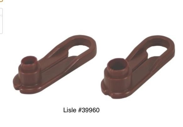

There were(at one time) some counterfeit Mishi’s on eBay, maybe that’s over now. I bought one from XDP a couple of years ago and have been happy with it. If you have the quick-connect fittings on the radiator lines you will need a specific tool to release them. The fuel line tools you may already have won’t work.
This cheap one works ok.
I hope I didn't get the counterfeit one! I did order it from ebay and it was $358 from Royal Radiators. I will have to look at the connections to see if I will need that tool. It got cold here in Ithaca and didn't feel like messing with it this weekend. Thanks

If you have the stock radiator you'll need the tool to disconnect it. If you can find the tool in metal get it. I broke two of those before I got the metal one. I will say I got aggravated and forced it was why it broke
Thanks! Ill look for some and try to get the metal ones!
