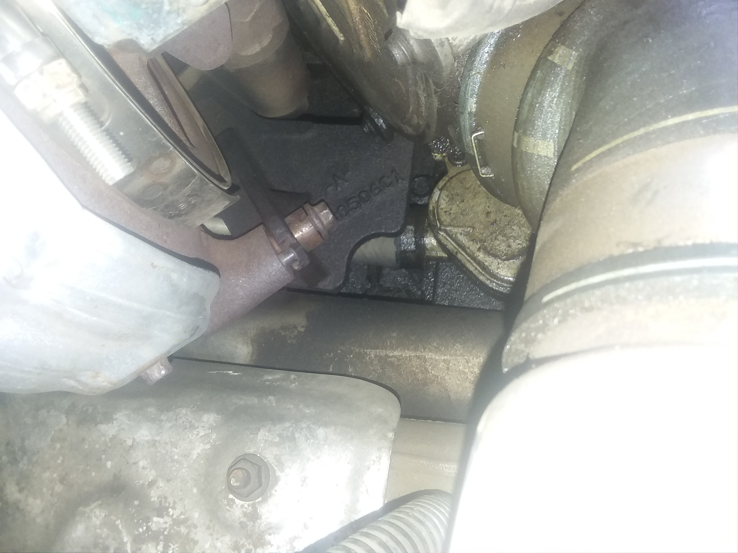

Size:  1.51 MBHey y'all just got this truck. 2003 f350 6.0l it has 160xxx miles. Can Anyone tell me if the egr has been deleted? Thanks!

You should probably start a new thread. But you can't tell by looking, someone could put in a plate to block it off.

No, EGR cooler is NOT deleted from what i can see. If you pull the EGR valve and it is carboned up then you know the cooler is not blocked off.
To add, your intercooler boot off the turbo appears to be leaking by the looks of the oil from the crank case breather system.
Also, that turbo mount bolt in the picture is loose.
Like posted above, start your own thread. If you have concerns or questions post pics (more the better in my opinion) and your questions.
