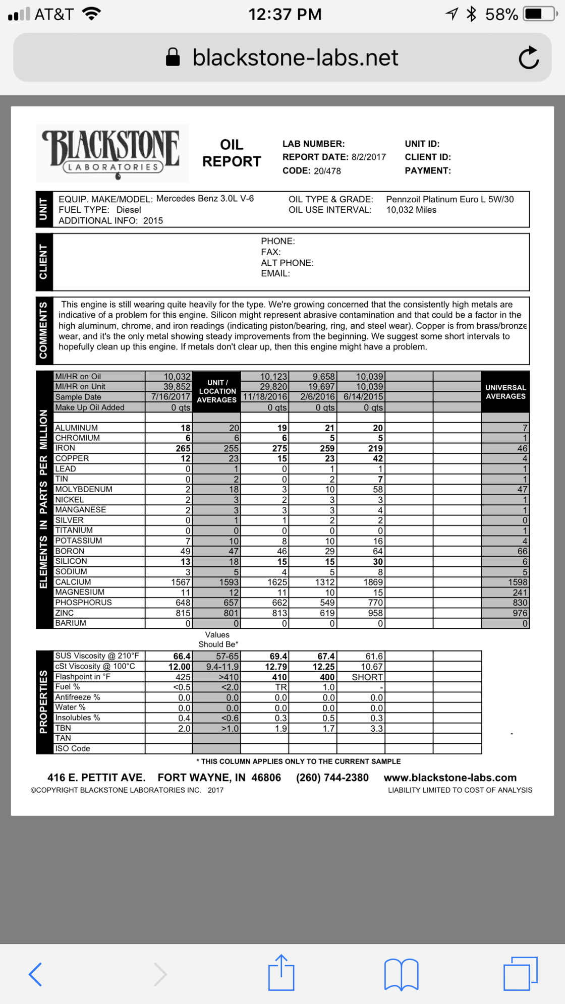

I disagree...look at my wifes Mercedes Benz...2015 GL Bluetech diesel. Family vehicle and not driven aggressively. I have followed the Mercedes oil change interval and actually changed the oil slightly early at each oil change. Basically running 10,000 oil change intervals here. I have only used super premium oil following the MB spec.
This engine never had a chance to flush it's break in metals.
All these metals are flowing right through the filter and getting more opportunity to create an abrasive environment for all the moving parts.
If the filter would capture these then you wouldn't see these in the oil.
Also, silicon is what indicates a dirty air filter. Much of that material is not captured by the oil filter.
Your big wear metals are Aluminum, Chromium, Iron, Copper, Lead and tin.
Today it's running just fine. Not burning oil. Everything seems A OK. It's on a lease and we turn it in at the end of November.
Under the surface something bad is going on with this engine. It will likley make it though the warranty period...but owning this engine long term is not anything I would want to deal with considering the repair cost on expensive diesel motors like this MB unit or the PSD.
Early oil changes are cheap insurance.

The filter does not remove all the harmful particles in the oil. The size you are most worried about is the size that matches the oil film thickness in the journal bearings. That is around 10 microns and most filters only filter well down to 20 microns. Larger particles can't pass through the bearing clearance, and smaller particles pass through without touching much. It's the particle that is the same size as the oil film thickness that does the damage.

I'm using AMSOIL Ea oil filters...they filter 99% of the 20 micron size particles...Supposedly (according to them) quality competitive filters are only 51% efficient at 20 microns.
If someone uses quality oil and crappy filters you are probably wasting money on the oil.
