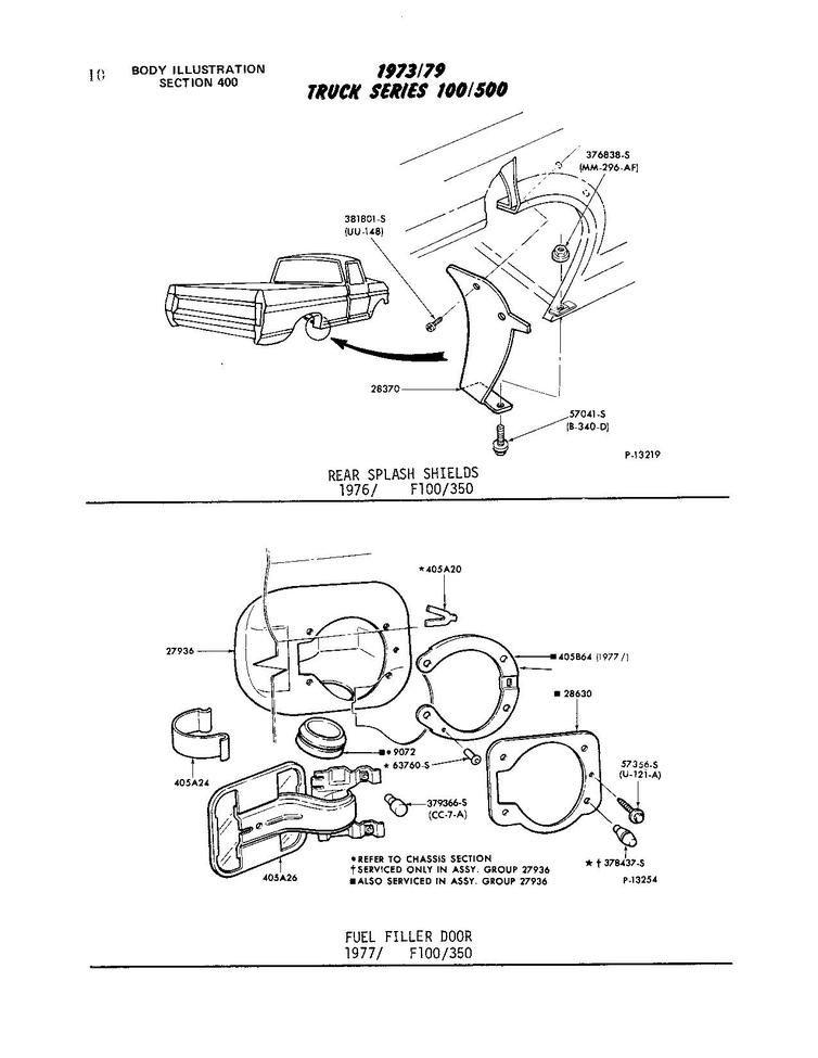

Can anyone recommend a good replacement option for the rear wheel well liner / wheel housing / wheelhouse panel?

I think that the rear wheel liner (28370) is just 1 piece (in the diagram) of fairly flat plastic that are more like deflectors..and not a true wheel well liner like the front is on a 78/79. We all know though that there is a front and back plastic piece.
Some thread on here a guy used a plastic front wheel wheel liners and MADE them fit the back. Some cutting and working over, (heat gun) and they were made to fit and they looked pretty good. I thought it was a cool idea.
NOT exactily the thread I am looking for. https://www.ford-trucks.com/forums/1...r-options.html
After using the advanced search and reading a # of old threads I can not find the pics. But talk about using some from a Super Duty was discussed....

I've just about got all the parts I need lined up! Can someone tell me what 405B64 and 28630 are called? Fuel housing gaskets?

SWAG...Filler neck gasket? Have you looked here? https://www.fillernecksupply.com/197...ler-neck-hose/

The thing to be careful about it removing the old # 9072 and breaking the plastic mount # 27936, if you are putting on a new one. Old gas make that rubber gasket hard as a rock.
