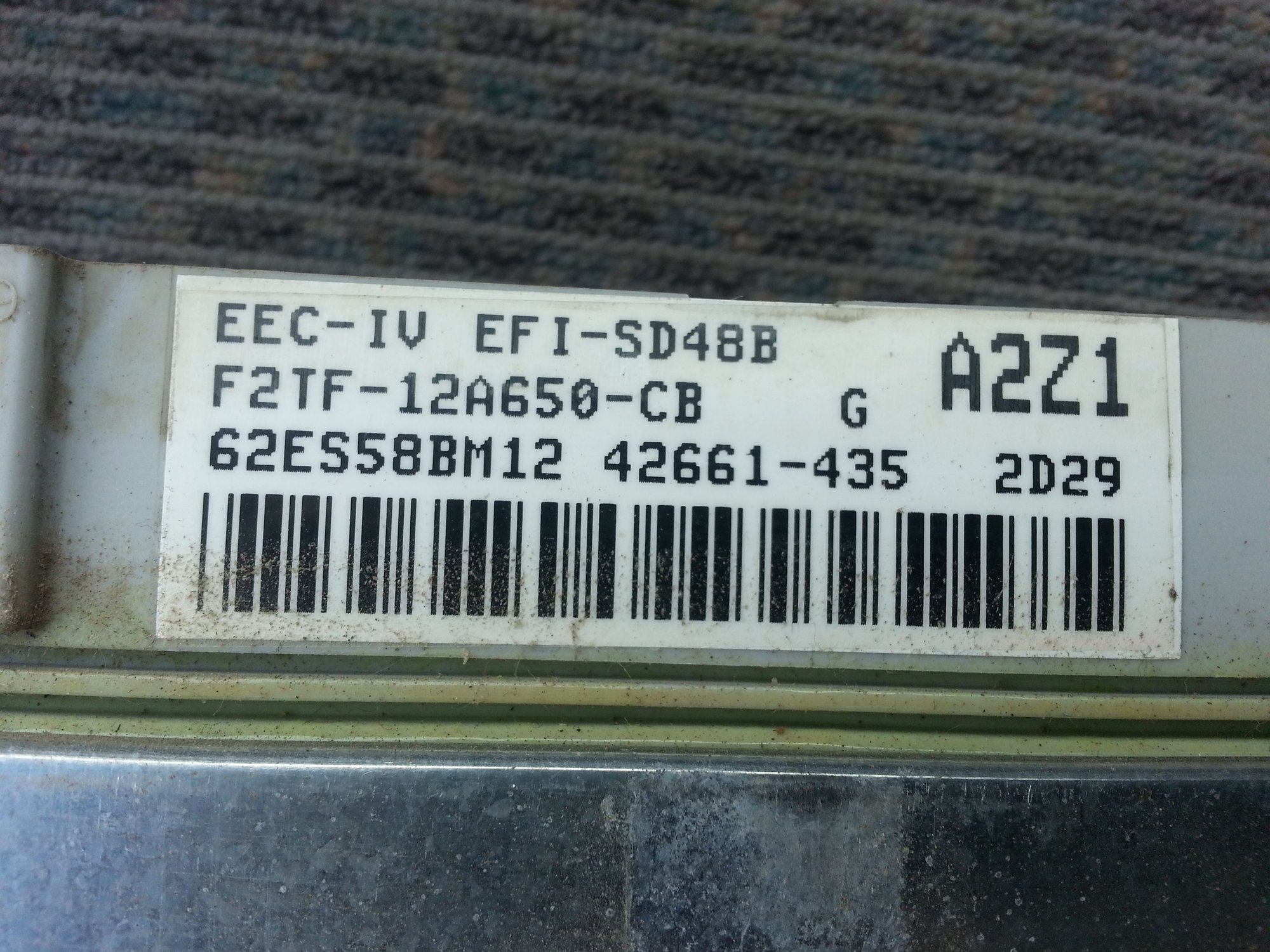

Your existing door post calibration will be irrelevant as it is for the 5.0. The options you describe are pretty standard, just find a similarly equipped truck and you should be close. E4OD control is important here. 4R70W, C6 or manual transmission will not work with your transmission.
I did wreck a similarly equipped truck. Pics of the door post and the ECM for your consideration. ECM catch code is A2Z1. Truck is a 92 F150, 5.8, E4OD 2WD.
