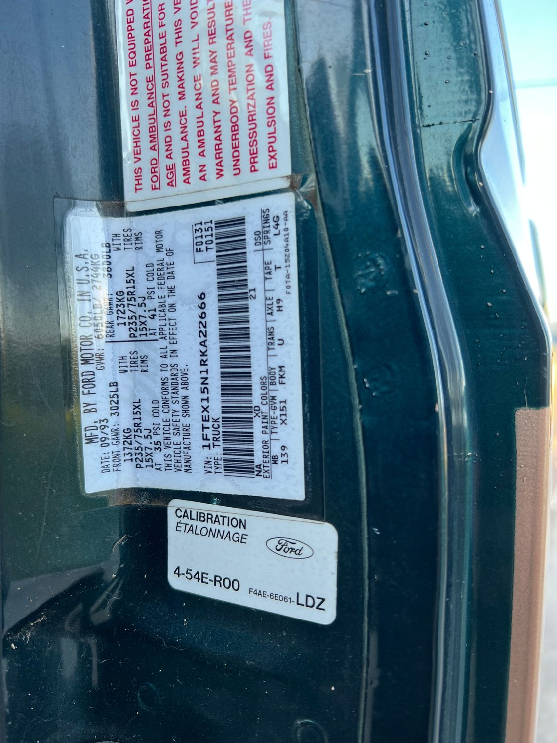

1993 f150
Hey, I see a bunch of PCMs being found from door codes, how is that done? Where do I look for that info. And if it is hush hush, my took a crap and I need a new one too.
PCM pulled out is f4ft-12a650-apa
but the casing has older numbers, possible reflashed at one time??
The door code 4-54e-r00
tia
Old Nov 1, 2021 | 05:16 PM
subford's Avatar
subford
Joined: Aug 2005
Posts: 23,667
Likes: 301
From: Easton,Ks
For the CALIBRATION code of 4-54E-R00 with a 5.0L MFI engine.
PROCESSOR AND CALIBRATOR ASSY., (EEC-IV) the number on the part is F4TF 12A650-APA, and the Ford part number is F4TZ 12A650-APA.
