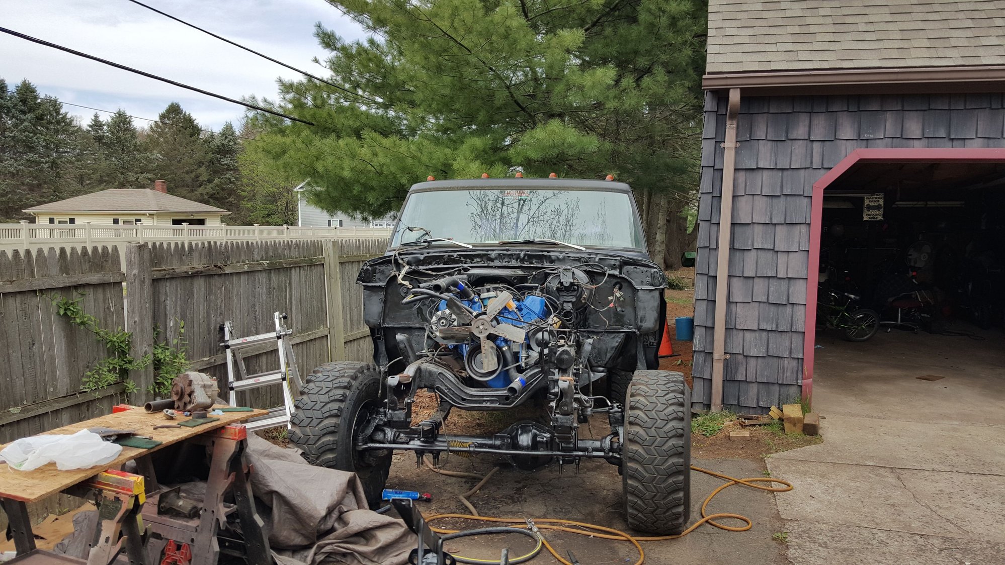

Original poster here. I see a lot of pictures of people just removing the radiator support which I like because it's a one man job. I never attempted it because I am wary of the fenders just hanging there for what might be weeks. Has anyone here gone this route? Thanks for all the replies. Below is a pic of my first choice, taking the whole nose off.. I did this 2 years ago with some help of a neighbor.

I took the grille and core support off on my '72 to remove the engine. It was a pia to get to the grille bolts, and one of my core support bolts was seized with rust because water lays on top of it, I had to cut it off.
As far as "hanging in the wind", I never saw a problem. The fenders are still attached to the inner fenders so it is ridgid. I understand your thinking, but it isn't how it is.

X2 on if you take just the grill shell and the core support off, all the bolts that hold the grill shell and fenders to the core support are a PITA coming out and going back in IMO. Then there is all the alignment issues....
And you have to contend with the core support to frame bushings and bolts either way.
As far as fenders just hanging there...no real worries I guess, there are the 1 middle and 1 bottom bolt and then the 5 that bolt the fender to the inner fenderwell and the 3 that hold the innerfenderwell to the fire wall. So there will be at least SOME support.
If you at least take the battery out and the hood off, that weight will not be pushing down.
If you are going to just take the grill shell and core support off, take the side marker light lens out to be able to go in thru that opening to get to the couple upper bolts in there.
Did you go to that link I attached? That is a walk thru reminder on how easy it is just is. 12 bolts. Unless you have the front fender support bars than add 2 more. And the rubber straps that go from the inner fender to the fire wall add 2 more.
So maybe 16 total? Good luck and post some pics.

I have done it both ways, and I would never just take the grill and radiator support off, unless i needed to work on one of them. I would find a way to pull the front clip.

Thanks guys, I'll just have to find someone to help me take complete nose off.
