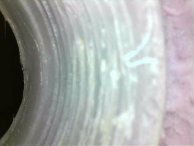

When I put in the plug I may have used a minimal amount of teflon tape, or at the very least not much. But even without teflon tape the extension fitting should have come to a point where it wouldn't turn any more because the fitting had reached the end of its threads.
I should disclose that the new fitting was ABS plastic not PVC. The old plug (which now has problems getting started) was PVC. At the store the threads for both ABS and PVC seemed to be exactly the same. But maybe not?
My goal of running a tap on the threads is mostly just to clean up the threads to make sure they are as good as they can be given the circumstances.
I tried to get a picture of the threads with my USB inspection camera. I'm still learning how to use the camera and the photo isn't that great.

Couple thoughts. The treads are the same and interchangeable. Since you are trying to chase tank threads, which are soft, you should be able to use a 1 1/2" pipe nipple which is much cheaper.
Steve
