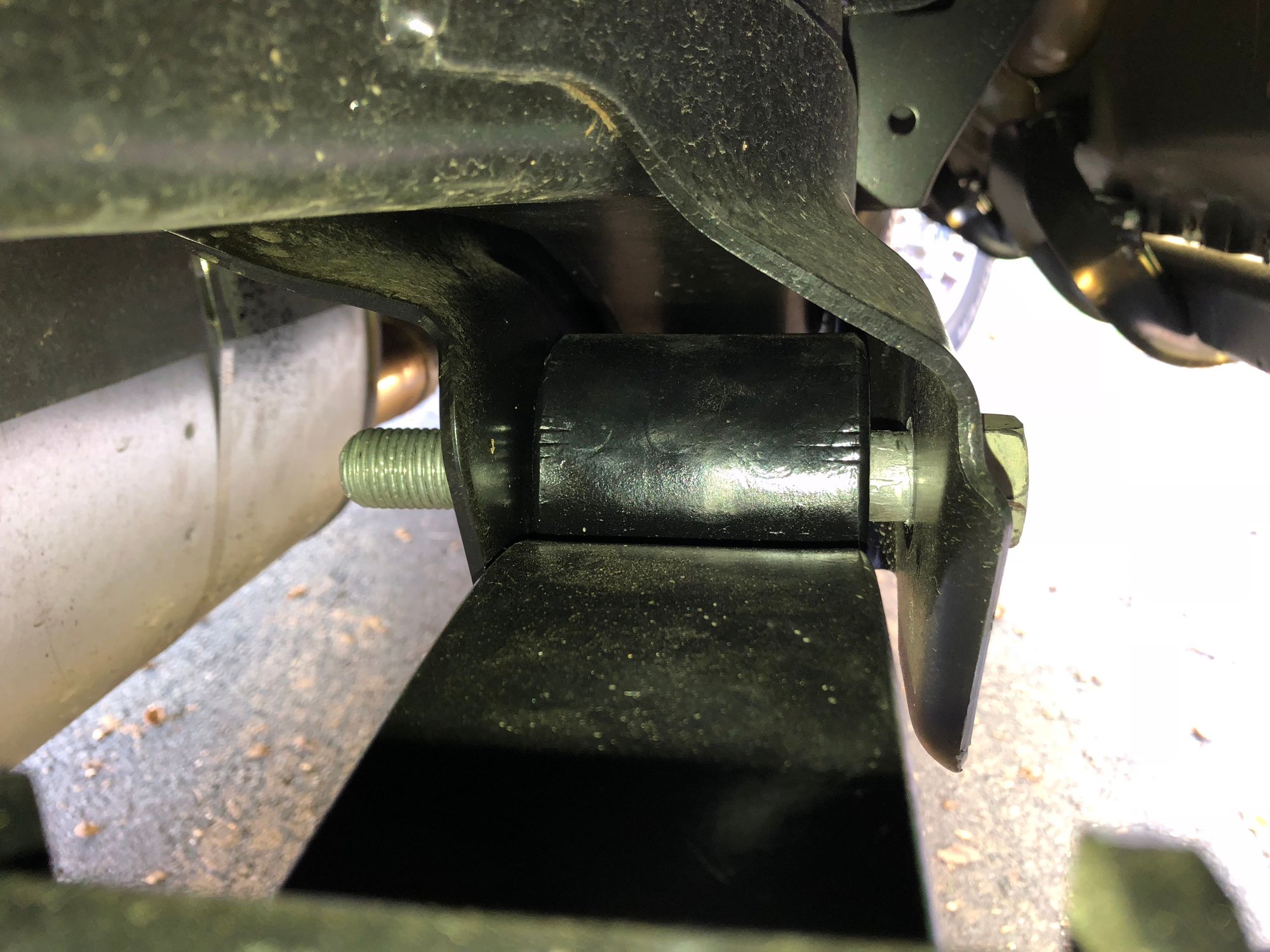

The odd install issue was the spring perch being wider than the bushing. That leaves about 1/4 inch of space side to side. So if I hear them moving or squeaking I’ll have to add a washer or spacer. The Ford bushing extends out past the spring edge and obviously the Deaver bushing does not.
Oh also the front bolts needed to be cut out. The other option was to drop the gas tank but that seemed a little to difficult. Not sure why Ford chose the orient the front bolts with the head in and not out.

This is a clear picture of the spacing gap I was referring to. Maybe 1/2 inch actually. I’m think some kind of rubber and metal spacer? Any ideas.

A poly bushing would work great in there. Interesting that they didnt make you one for use without the block. Isnt that what the Carli full deavers are?

You definitely need to get a spacer (s) in there as that is not even close to tight, the bolt should flex the sides in slightly to put pressure on the inner metal sleeve of the bushing, that will cause all kinds of problems the way it is. On second thought, I would contact Deaver and see if they have a bushing or sleeve that fits properly.

Send them the pics and see what they say.

You cant use a poly bushing here. Normally the inner sleeve sticks out past the leaf coil. You need to use a metal spacer that will keep the bracket/flange from collapsing when you tighten it down. It needs to be large enough to put the bolt thru but small enough that the actual leaf will not touch it.

i'm also for some sort of a poly bushing in addition to a crush sleeve inside of the bushing so you can tighten it down and not smash the bushing. But maybe theres more to it then we can see from 2 pics lol.

I don't know what diameter the bolt is, but when we have this type of issue at work I find the appropriate size pipe with the correct ID and cut whatever size spacer I require. Basically a thick washer.

Thanks for all the responses. I’m thinking I’ll go to the hardware store today and locate a spacer or something.
Yeah I don’t know what Deaver was thinking by making these with a short travel. I didn’t know they even did that at all. Honestly I’m not going to complain yet cause at this point I got the current springs for free. If I’m happy with them then I’ll just keep them. I’m definitely going to give them the benefit of the doubt and try to make them work.

Don't think of it as a complaint, rather R&D. I would still let Deaver know that the the bolt sleeve is too short and send them your pic. Maybe they aren't aware of it and that could help them and someone else down the road.

I ended up putting some washers in the leaf spring pearch. Everything seems great since then. I don’t go off road but I do have some stupid bumpy road around me here in Massachusetts. These Deavers along with the Fox 2.0’s are great! Bang for the buck I say the fox shocks are a much better ride quality option (especially since they don’t reduce your payload) but the Deavers do add an additional bit of softness to the rear end. I’m very happy.
2 washers on the outside and 1 on the inside.
