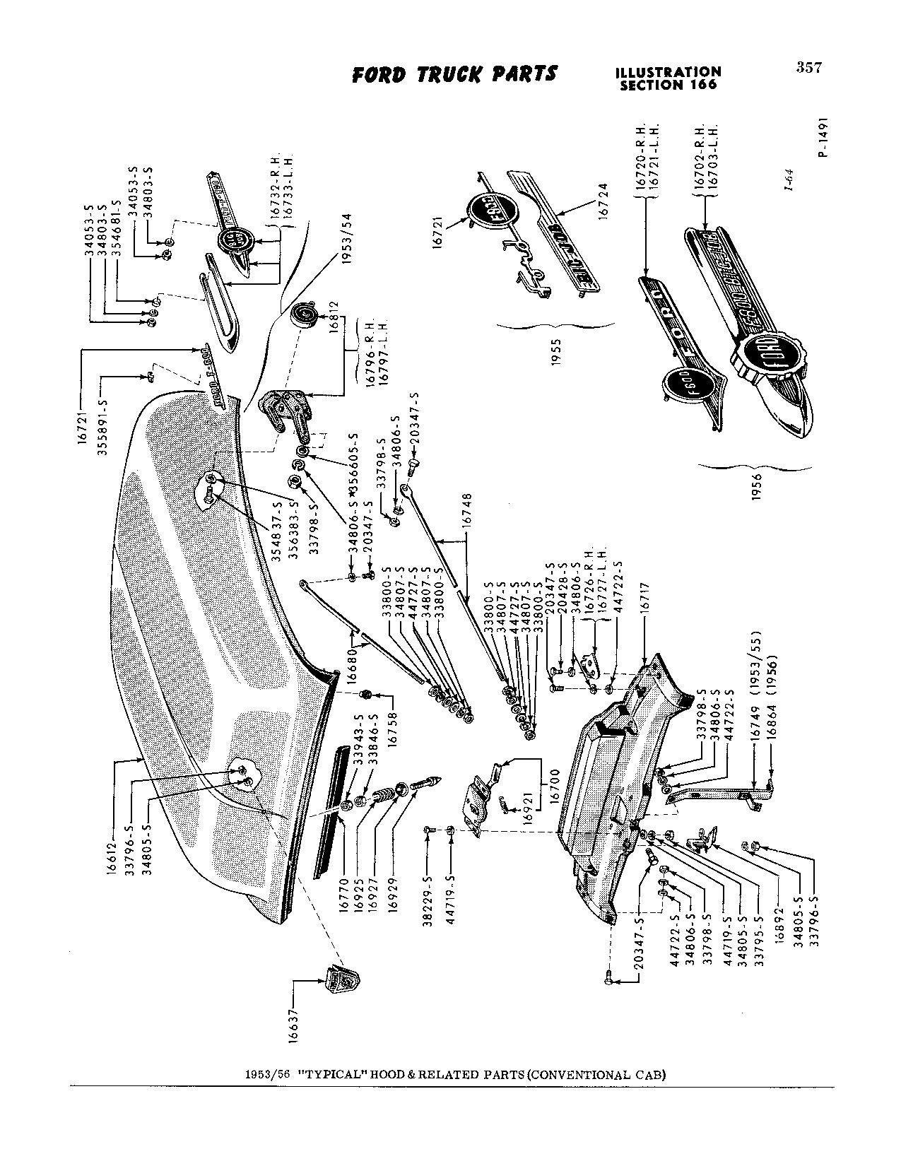

16726/16727 in pic:

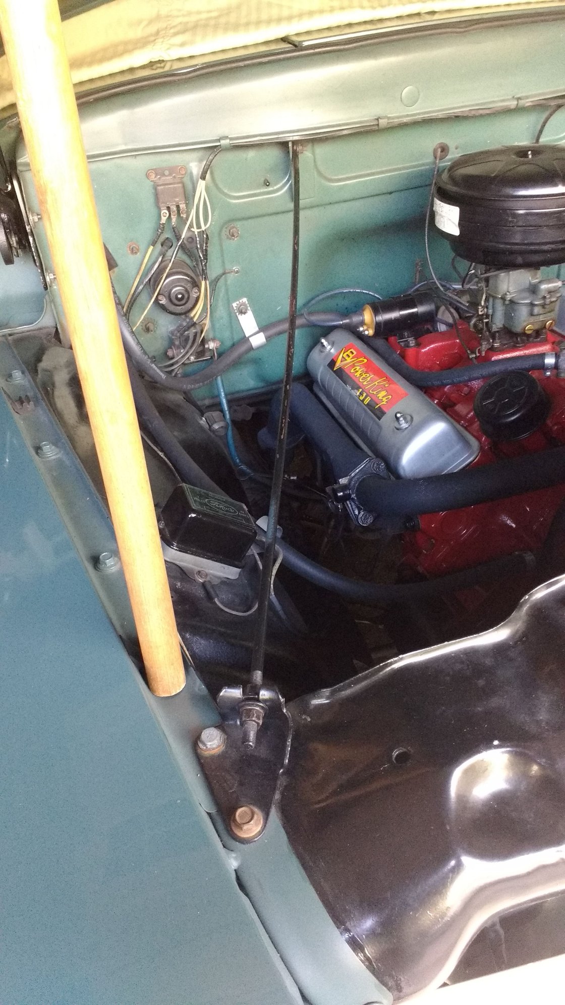

Here is the rod on my truck.
