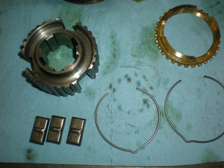

I am trying to reassemble a 51 3 speed synchronizer and having some trouble. The synchro clips (inserts) were damaged and fell out when I disassemble the transmission, so I am not sure how they were installed.
The Ford manual says install the inserts and then the retaining ring. Based on my attempts and how the brass synchro rings go together This does not seem to work.
Any help will be greatly appreciated.

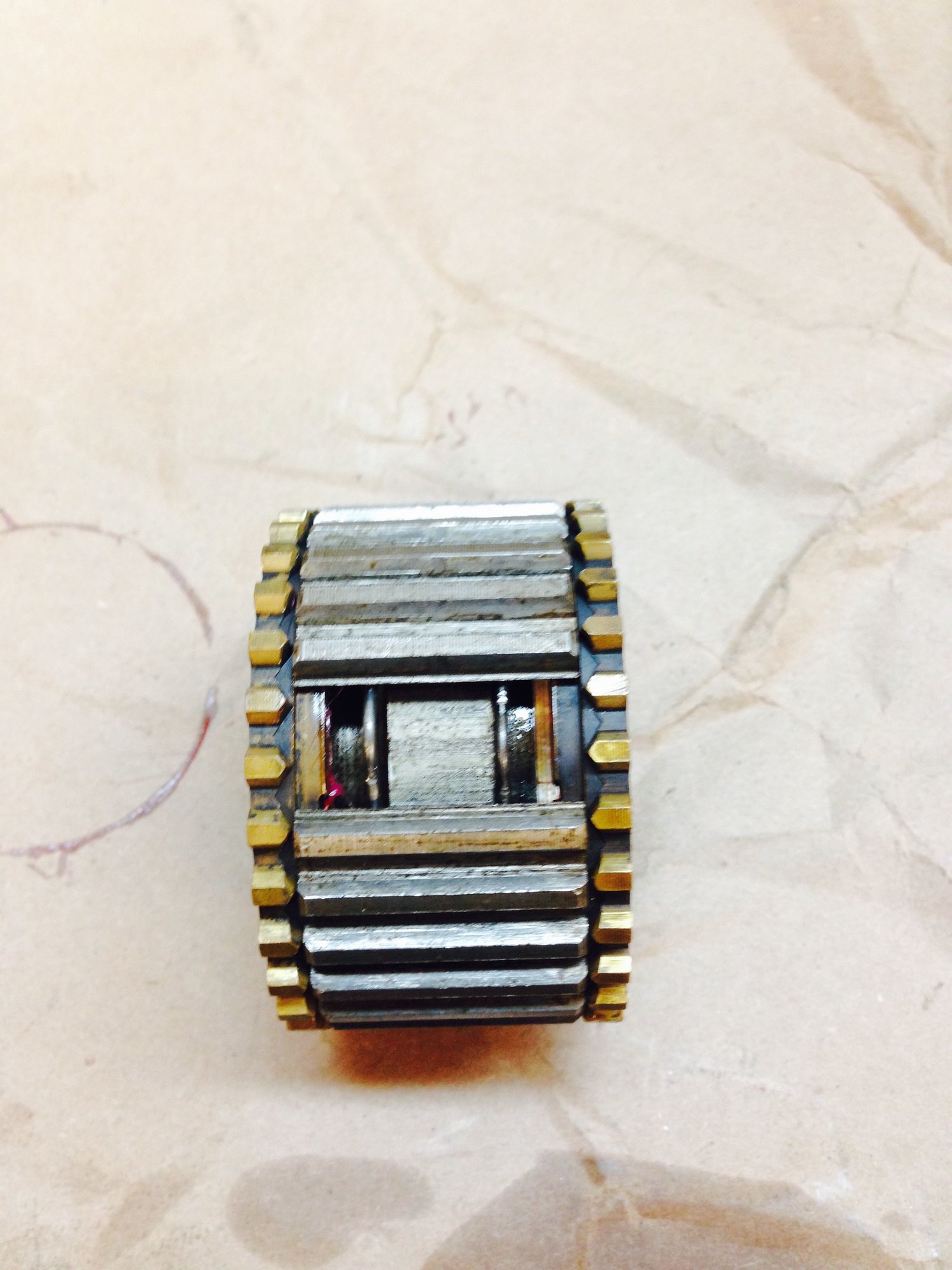

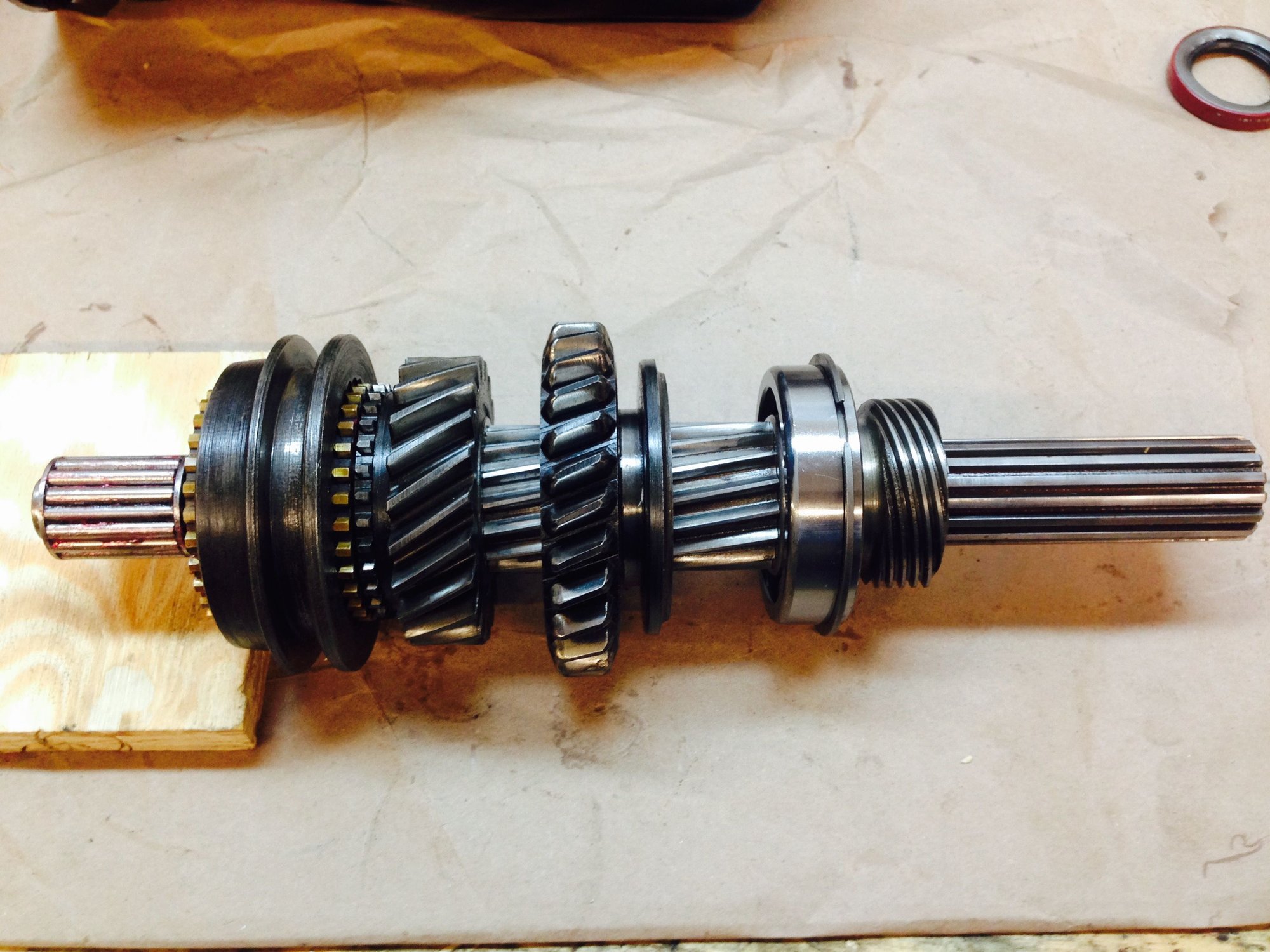

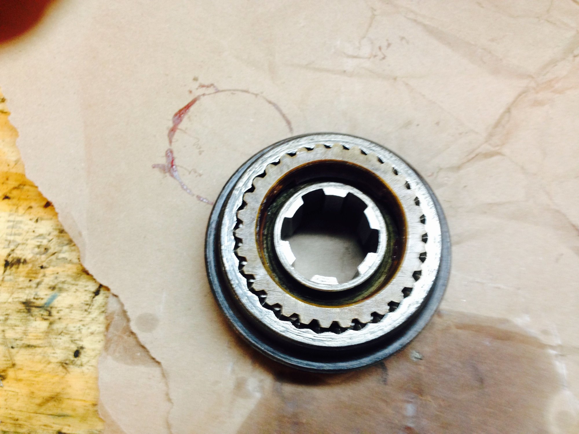

I’m not sure I fully understand your question but here are a few pictures I took
The snap rings are in with the brass synchro rings on either end of the center hub
Then the clips are placed on top of the snap rings. And the sleeve is slid over the top.
Then the hub slides over the shaft
I’m not sure if this is any help to you or not.
Keith

Yes, that does help. The manual said put the inserts on the center gear first then the snap ring, that just does not work.
I was pretty sure that was how it had to go, but your pictures make it clear.
