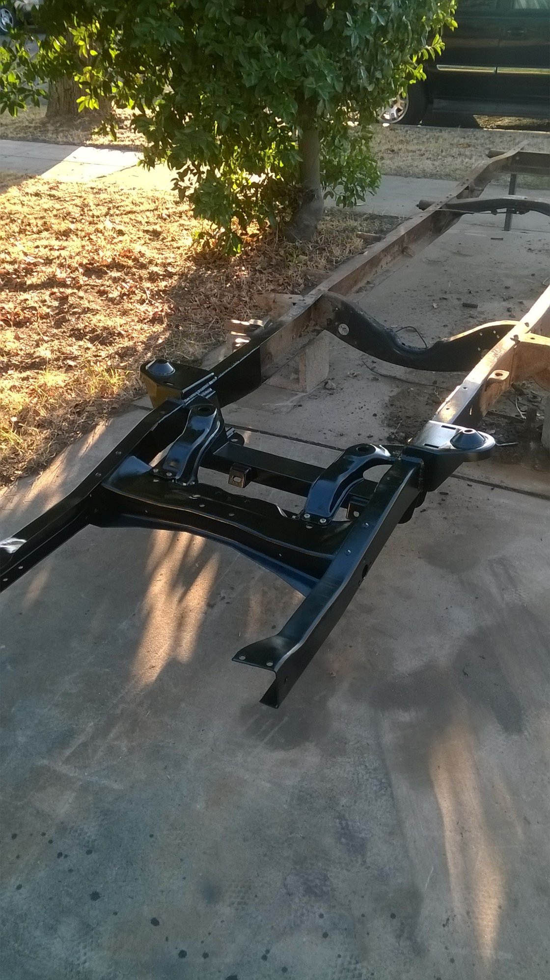

Thanks a lot. Hopefully getting the axle and four link in this weekend so I'll post some pics. Here's the front end so far Say something about this photo

Looks nicely done! Are you keeping the stock engine? If so, why the 4-link? Just for ride height?

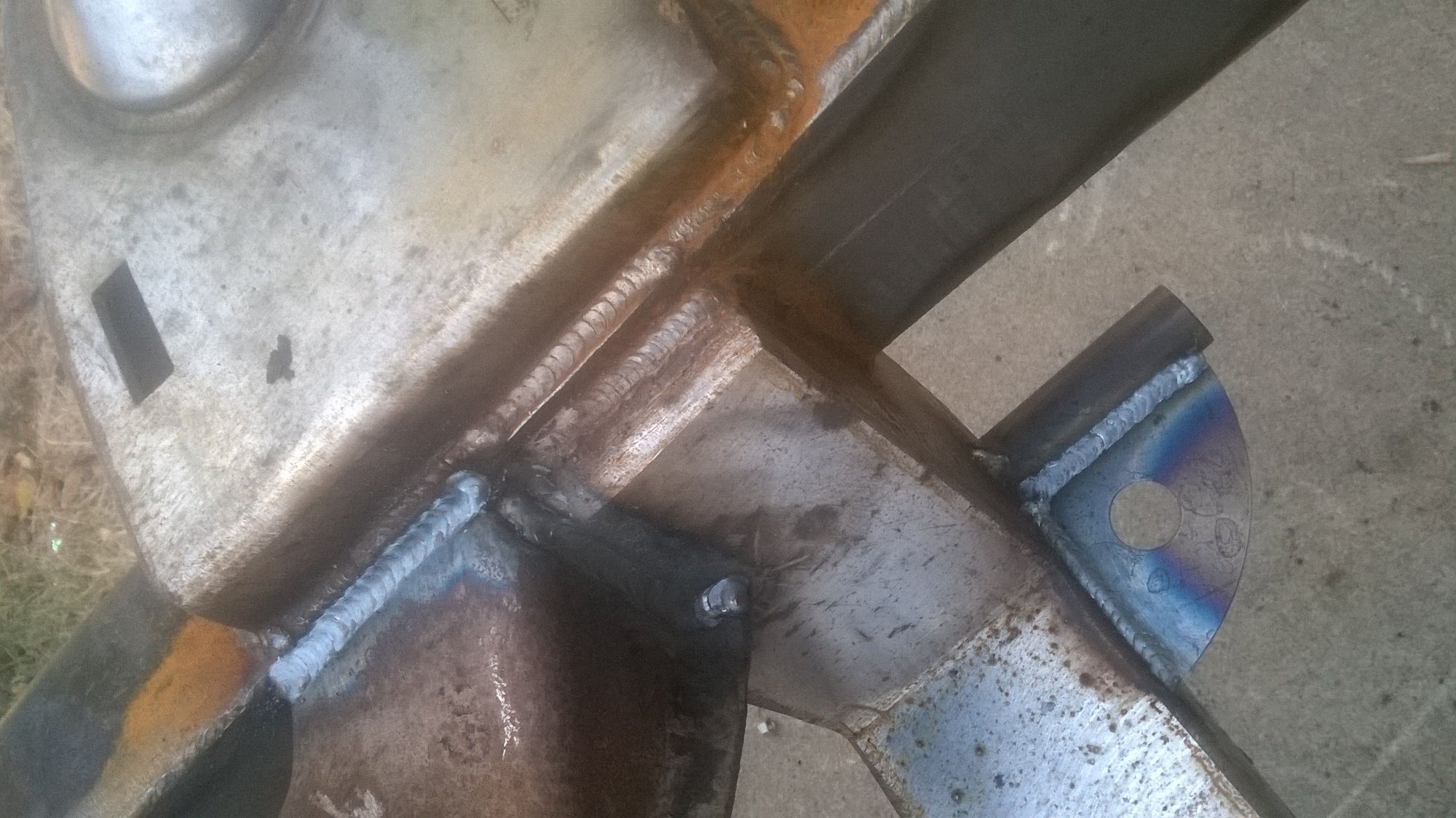

I would of kept stock suspension but I cut the front stuff off about 20 years ago. As a teenager didn't have money and the truck sat. I decided I want to add air ride so that's why the four link. And yes it will have the original flathead.i trimmed the mounts to fit and welded them in. Motor is. .030 over, domed pistons, stock heads and I'm waiting on some center dump headers from speedway as well as a Meyer intake. I will be running a t5 behind that. Say something about this photo

Damn nice welding!

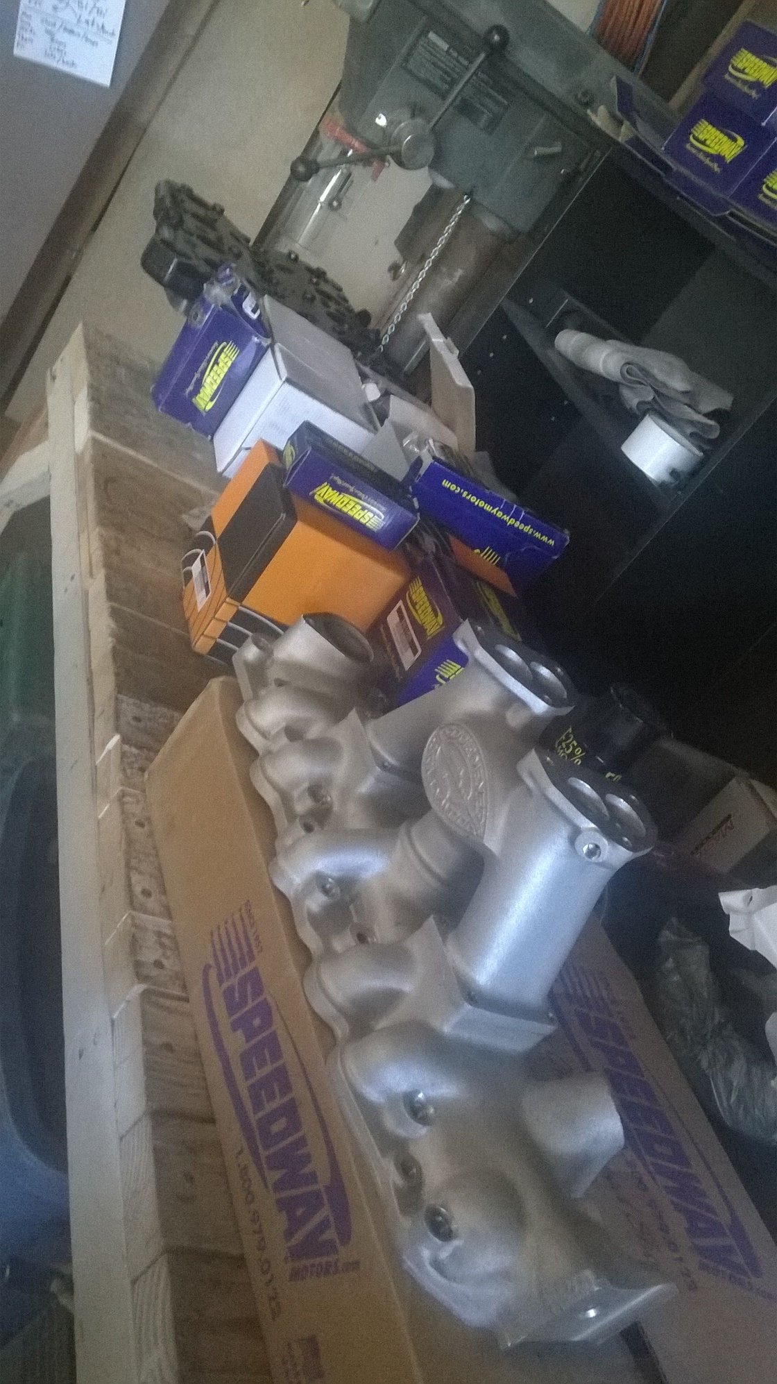

Thanks guys. Received a bunch of goodies from speedway yesterday so I'll keep everyone posted. Say something about this photo

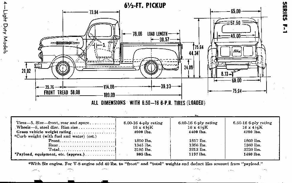

As far as locating your bed, the wheelbase is 114 inches as shown on above diagram. Even though that diagram is for a 51-52, ( grill is different), the wheelbase dimension is the same as 48-50.) Other dimensions are ever so slightly different too.

Since you already have the IFS installed you should have your reference point identified for the rear axle placement. Not much else to be gained with the bed. Come back 114 inches from the front axle/spindle location and call it a day. I like to run a couple of diagonals just to make sure that the axle is square to the frame.
