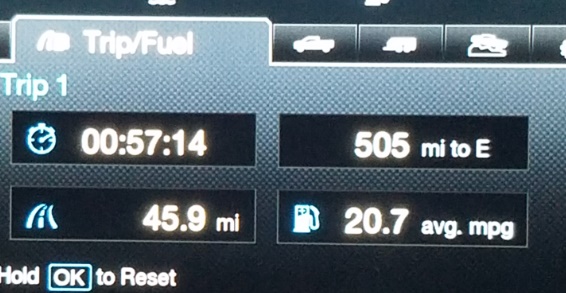

I record all my fill ups and mileage in Fuel Buddy. For the first four tanks it's calculated MPG for, it's easily been within 1 mpg - probably closer to 1/2 mpg.
My daily commute is about ~55 miles each way. I filled up at my usual station this AM, which is about 1 mile from the expressway (and about 4 miles from home). My work is about 2 miles off the expressway at the other end. So all but ~3 of these miles were on the expressway. I decided to chug along at 65 mph this AM. Too bad it's not always like this:
Attachment 248210
This makes me excited about getting a PSD. I usually drive 60-65mph so anything close or above 20mpg is excellent!
Yes, but that is was almost exclusively highway. No way that holds up when you mix in some city driving. I'll wait to go through another half dozen tanks (and the engine breaks in more) before really commenting on real world MPGs.
