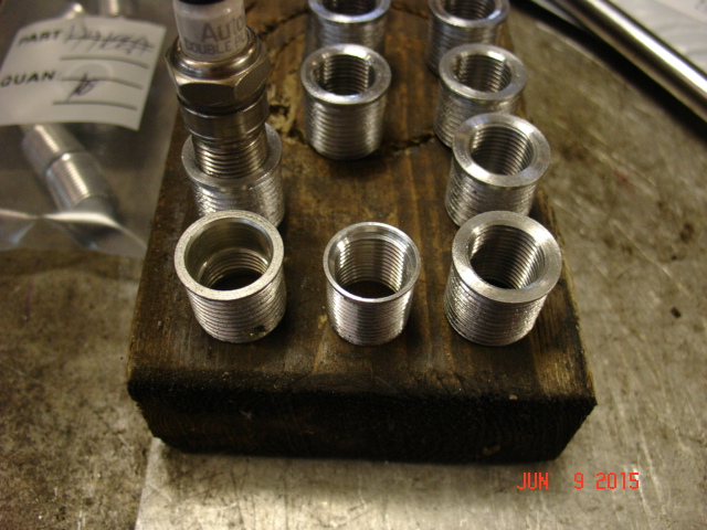

https://www.ford-trucks.com/forums/1...y-deuce-5.html
Post #141
51457A timesert I believe is the thicker better insert to use that is fully threaded.
Done with 5553 timesert installation kit
The 51457A is aluminum instead of steel (51459) as well as having full internal threads which really isn't an issue anyway on the 2V Tritons.
The OD, ID, and length OA are the same for both inserts.
Yes, the one on the right. Aluminum on aluminum in a heat cycling environment works well.
I went for the full thread insert on purpose.
