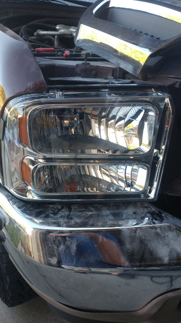

Thanks for the tip on the adjustment screw...the passenger side hits a little low as compared to the driver side...and I'll need to check both for general height anyway.
A before/after pic of the driver side and an after pic of the passenger side.
I did have to do a little bit of trimming on the top of the clip that wasn't shown in other posts...the top inside edge of the light housings kept hitting the clip preventing the top inside screws from lining up.
VERY happy with the new light output vs. the old...even when the old ones were new they couldn't TOUCH what these can - whatever they did to the reflector design makes all the difference.

Looks good!
Did you use oem or aftermarket? 1Aauto? I've been contemplating this upgrade for some time.
