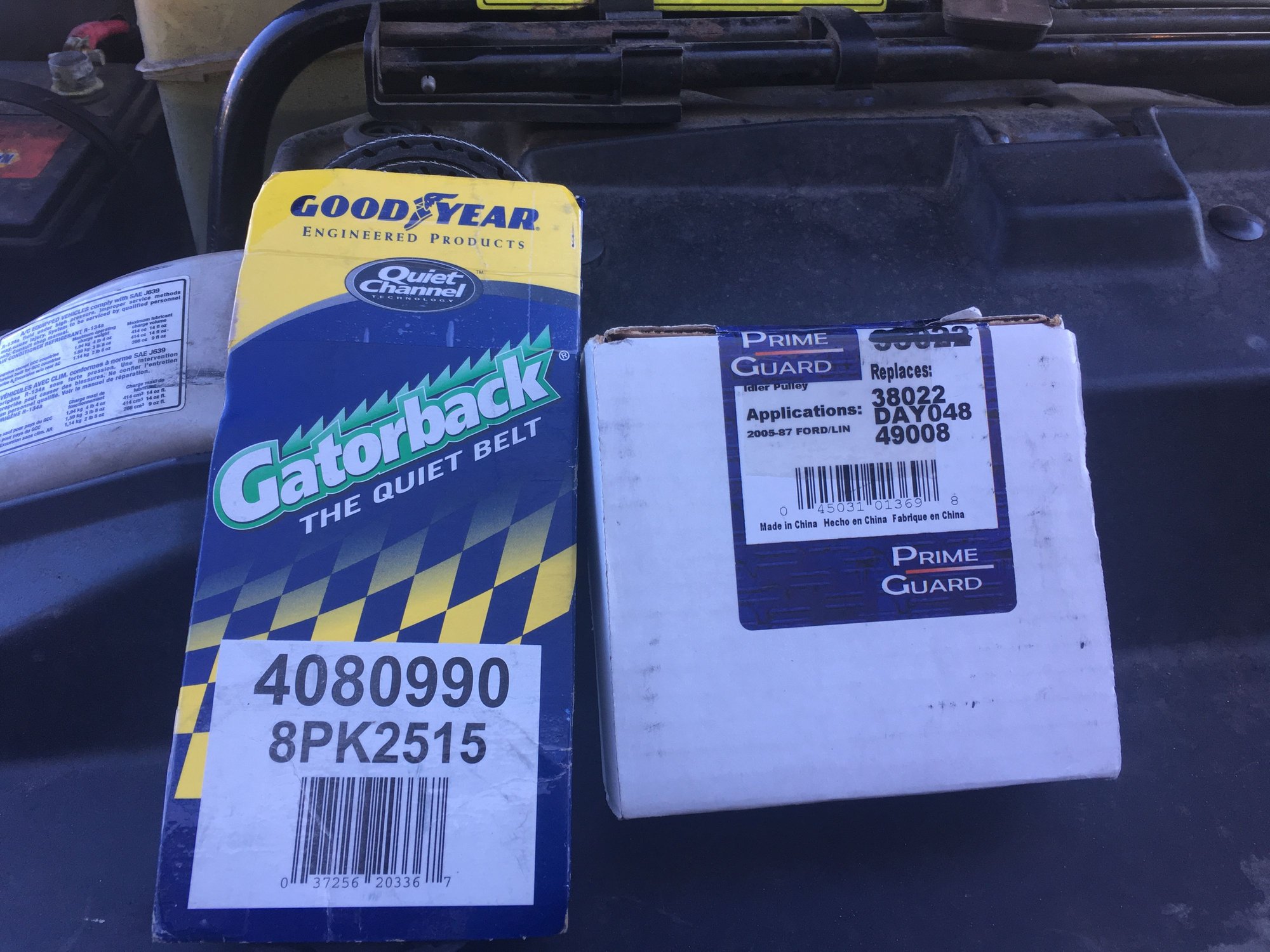

I litterally just did this on my V-10. best $32 I've spent
new belt and idler pulley
and the old one that was bad bearing and rusty vs. new

I'm gonna look at it this weekend and make sure I get the right parts and install new pulleys and a belt.
