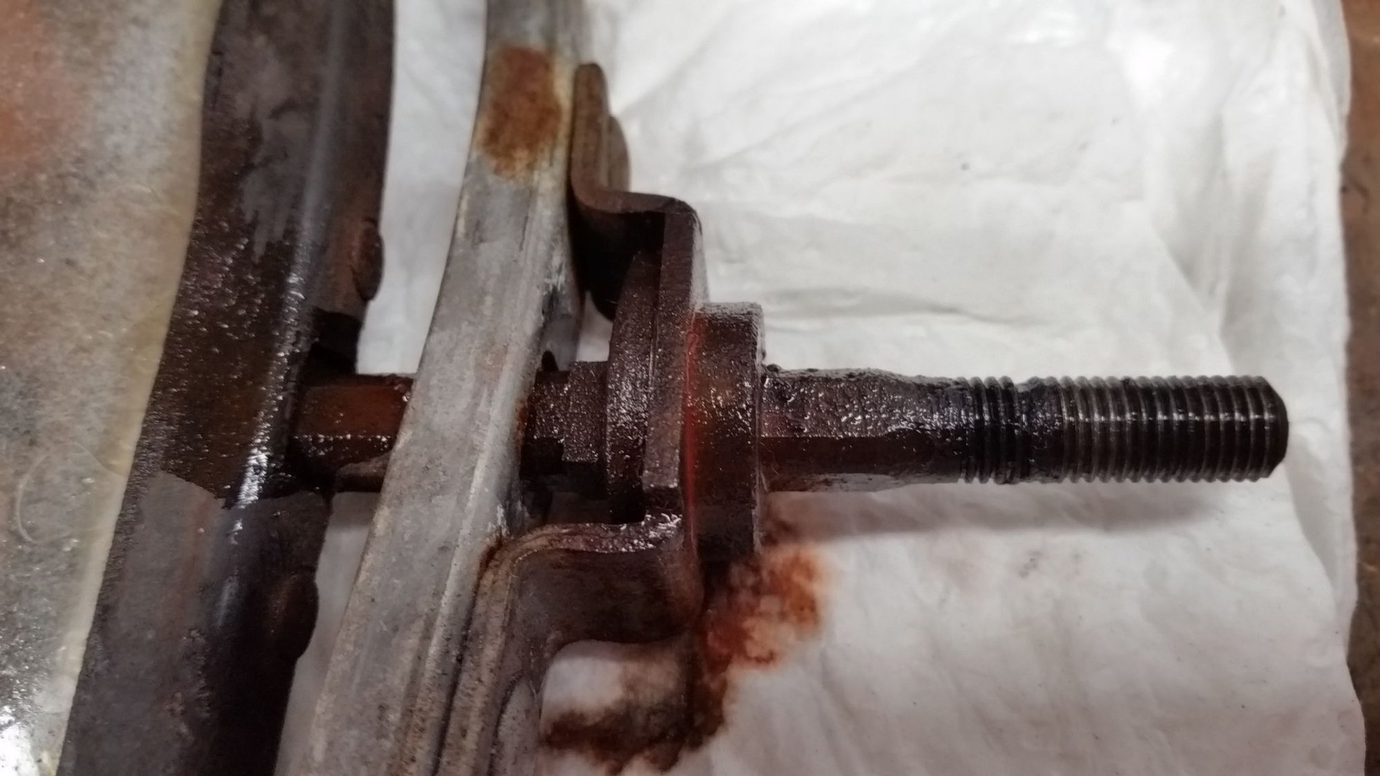

I've done some searching on here and picked up some pointers however i can't seem to find what i need to know about dissassembly. I want to get the window and frame out from the outer frame if possible. I took the nut, washer, and spring off the bottom of the pivot however i can't seem to figure out how to get the rest of it off...or should i even try? Here is a pic of where i'm at. I was going to tackle taking the glass out of the channel and cleaning it all up, dusting it with black and get ready for glass reinstall. Should i be trying to take this pivot assembly apart? It looks pressed in to me and the oblong washer can't be removed without removing the rivets. Maybe i just need to clean it up as is and leave well enough alone?

It's just rusted together. Will require some heat or force to get those washers off the square shaft. Try tapping on them with a hammer and punch.
It does need to come apart to install the new rubber correctly.

Of course, this goes without saying... Be careful that you do not break off the pivot where it enters the glass frame. This must be a weak point. I have two vents, one 53-55 and one 61-66, with perfectly good original glass with the FoMoCo name and logo in teh corner but they both have the pivot broken off.

When I did mine, before I tried disassembling the pivot, I sandblasted the lower end of the pivot stud to remove all the rust... this makes it easier to remove the stud once you finally get it to start moving. I then soaked it in a good penetrating oil (Kroil). I threaded a nut partially onto the stud to protect the end of the stud and began tapping it with a hammer. DO NOT HIT IT HARD! Just solid taps.... stop every few minutes and apply more oil... then tap some more.
It took a while, but eventually I got both of them free, with no damage to anything.
I can't tell from the pics, but have you removed the upper pivot? It has to be removed before disassembling the lower pivot.
-Bear

Thanks, i get it now. I was able to get them apart without damage.Cleaning them up now

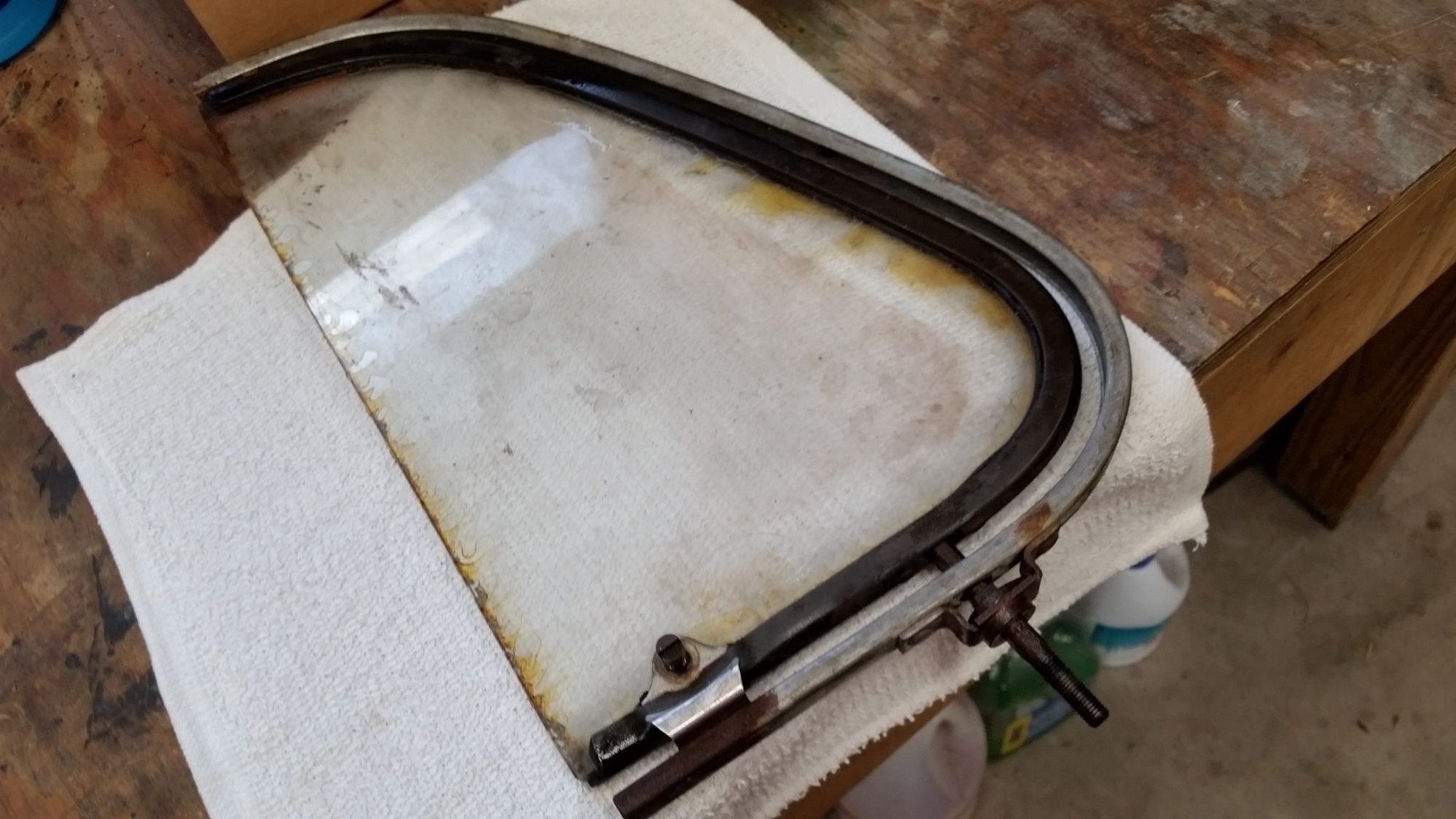

Looking for some advice from someone that's been down this road. I have everything needed to rebuild my vent windows so i'm proceeding with that. Most of my other components (division bar and window lift channel are in good shape metal wise but if i'm understanding it correctly i would need to replace the rubber vent seal to the upper part of the channel and the felt on the other side of the division bar channel. The new one's look to have rivets with them which doesn't appear to be much fun and i'm wondering if it just makes more sense to order the entire (anti rattle kit) from someplace like LMC or wherever. I'm assuming that the division bars that comes in the $199 kit would have both pieces already installed saving me some aggravation. But then again some of the quality of the "new" stuff is a bit off the mark.

When I reinstalled the glass in the frames on my 52 I think I must have pushed the glass too far into the frames. Don't do that..
There is quite a gap between the glass and division bar..
So I get to take it apart try to pull the glass back out little bit.
