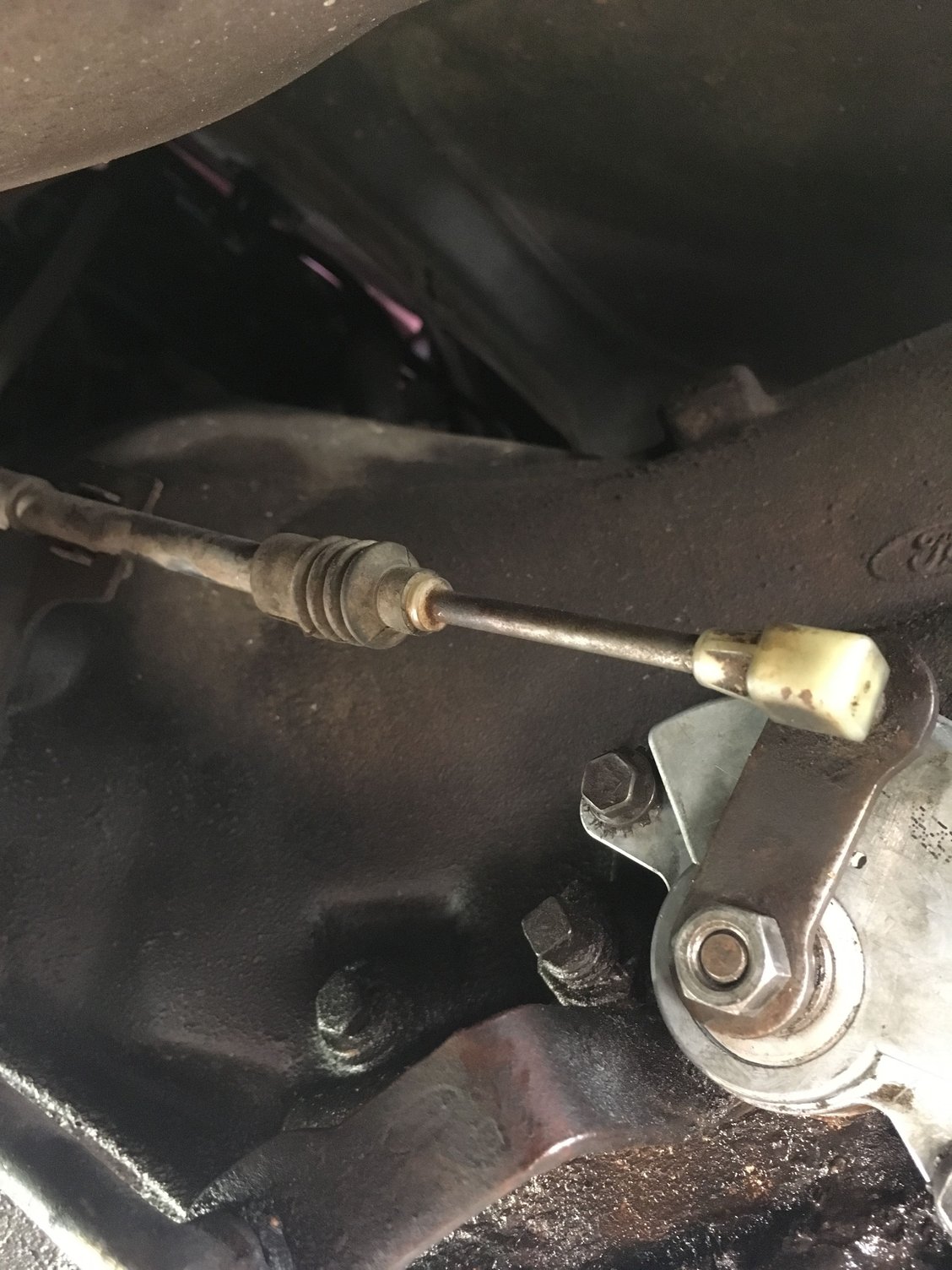

Heres a pic of the nee NSS installed. The park-gear linkage is the piece thag connects to the center bolt on the NSS.

I could be wrong but the one in the center goes to the carb for kick down linkage and the one to the left the gear selection no?
Or is it the other way around?
Dave - - - -

There are 2 options for home position: the linkage lever going to the NSS bolt being fully depressed or fully extended. I installed it the only way it seems to want to fit: fully extended. But that particular linkage can extend/depress with ease by hand while connected.

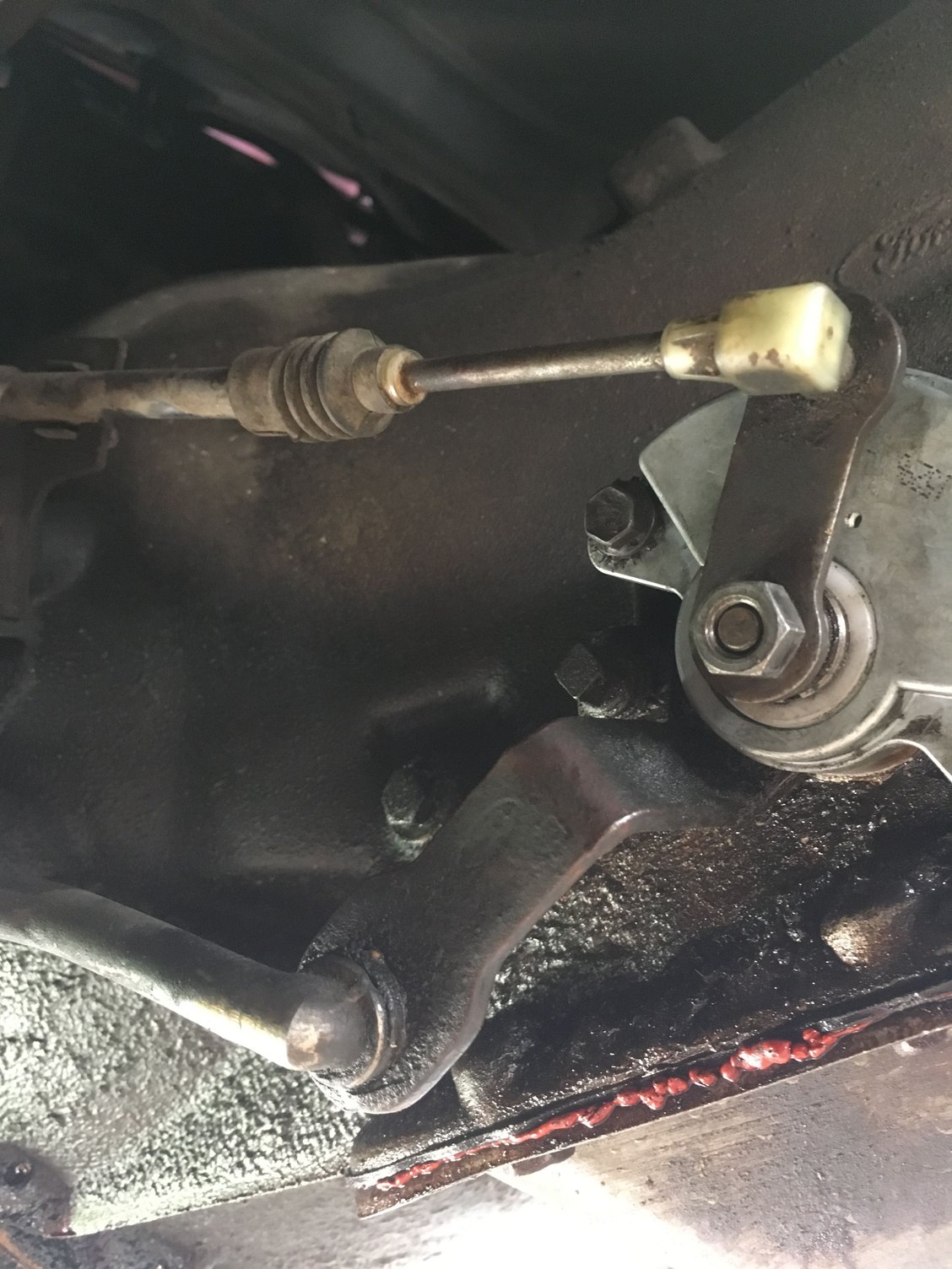

I had the older setup with the solid rod. It looks like you have a cable. My kickdown lever was spring loaded. When everything was disconnected, the kickdown lever (when it was free) naturally went to a home position from a spring mounted somewhere(I forget where).
Does yours have a spring on it and want to go to a certain position? We have a trans guy that lurks around here sometimes, he would probably know right away. If you still can't figure out where it needs to be, move it all the way one direction and road test it. If that doesn't work, move it all the way to the other direction and test it. If you can mount the arm hanging down or pointing up, that would mess you up if it was installed wrong.

I'm not sure if the kickdown linkage is a cable... or at least theres a solid rod that comes out of a rubber boot fitting. I'll attach a pic of it. No spring that I can see, though. I depressed the linkage and drove around, by the time I got back and parked it, it was extended again, so I guess thats it's resting position.
