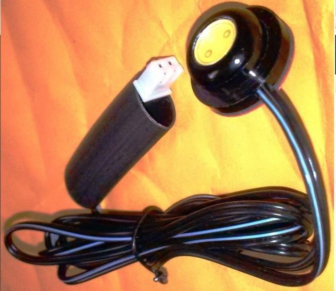

Gardner Bender GSW-124 Toggle Switch, SPST, ON-OFF Gardner Bender GSW-124 Toggle Switch, SPST, ON-OFF
Sold by: Amazon.com Services, Inc
Add-on Item
$2.65

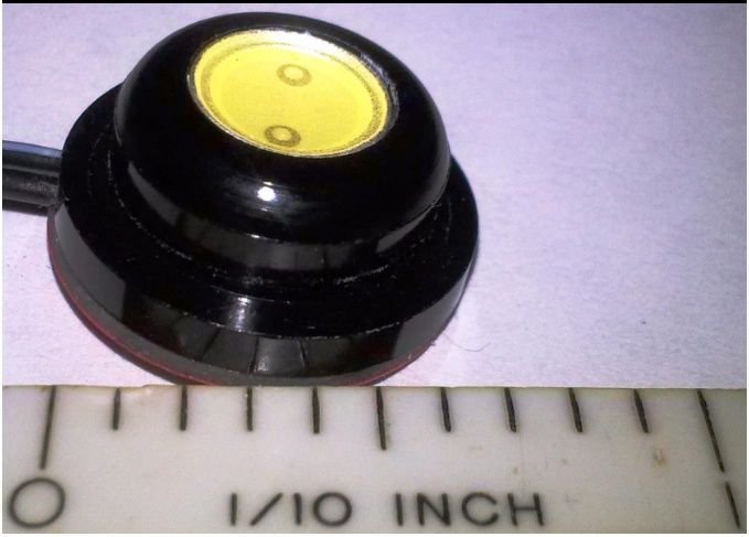

"><img src=" /> ">
Rayhoo 12V 3W Eagle Eye Lamp White Led Light Bulbs 100% Waterproof For daytime running lights DRL Car Tail Light Car Motor Backup Light Fog Light (12pcs, 3W Silver frame) Rayhoo 12V 3W Eagle Eye Lamp White Led Light Bulbs 100% Waterproof For daytime running lights DRL Car Tail Light Car Motor Backup Light Fog Light (12pcs, 3W Silver frame)
Sold by:
Rayhoo Rayhoo
Product question?
Ask Seller Ask Seller
$4.99
