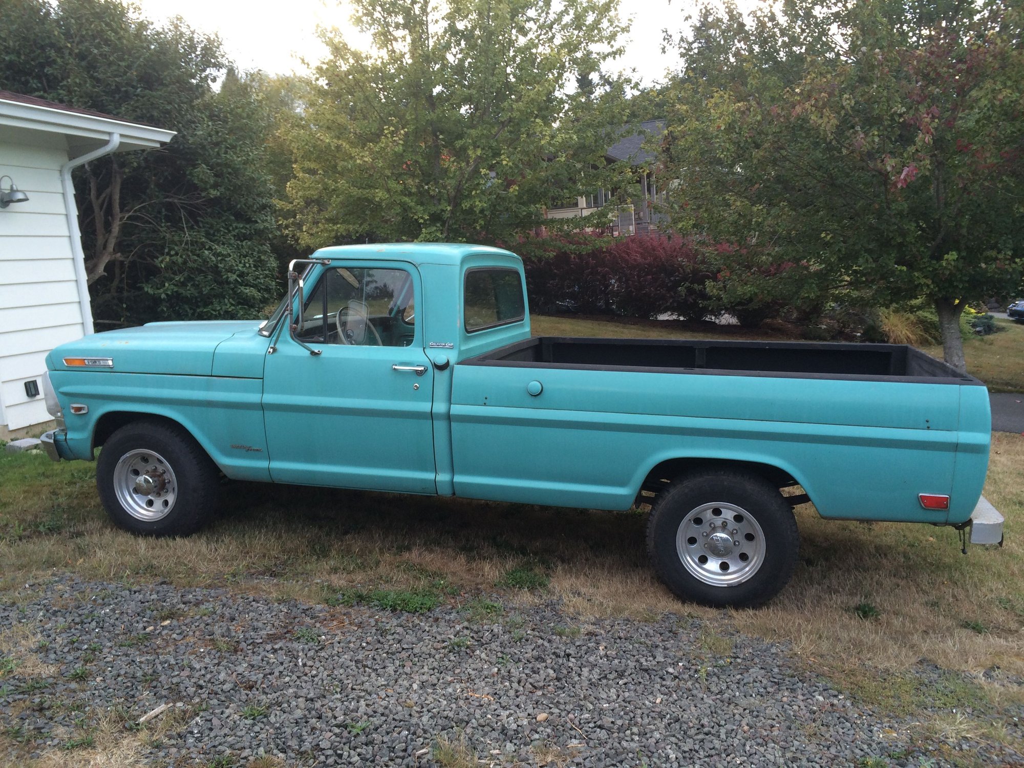

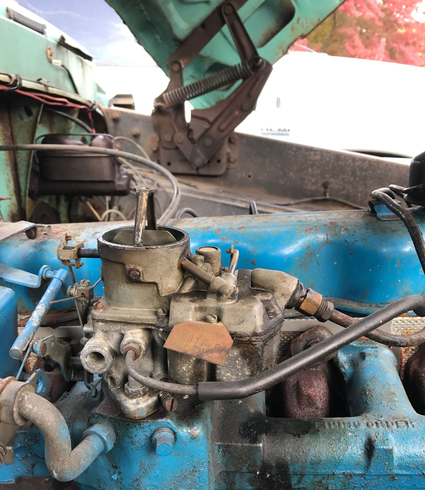

Good looking truck!!! I have to say I wasn't expecting to see a single 1 barrel carb!! Looks like a Holley 1940 carb.
The fuel inlet in the front looks like someone used jbweld or something to stop a leak I will guess, but you do have leaks and are in definitely need of a rebuild!! That should fix your problems with starting and even smooth out when driving it. 1 barrel will be very simple to rebuild too.. Just have two can's of carb clean a wire brush and a rebuild kit and take your time. Take pictures as you take it apart so you can go back and look at them for reference when putting it back together if you don't remember something.

The carb on your truck is an Autolite 1100 it was the least reliable of the Autolite carbs.
That's not saying it is a bad carb cause they are not and were far better than many 1BBL's on the market.
Some of the issue with the 1100's are that they would experience inconsistent operation due to the power valve design, and could have rather fragile castings, they were replaced with the Carter YF-YFA in part because of this reason.
But being an Autolite carb means it is stupid simple and easy to rebuild.
Mike has a good series of videos on rebuilding the the 1100.
Be aware that the 1100 came in a few different configurations with a spark control valve for load a matic distributors, and or a dashpot and or auto choke, yours has none of this stuff, and may not exactly match the one in the video.
