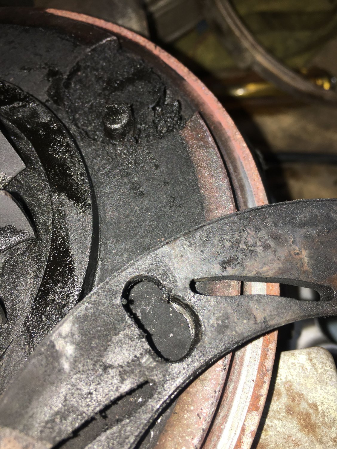

In the mean time Ive removed the turbo. The exhaust down pipe is wet, the exhaust up pipe is clean and dry, the outlet to intercooler has noticeable oil pooling in cac pipe/boot, the intake is clean and dry.
I split the exhaust side and the turbo is gummed up and seized. I will have to order a rebuild kit. With the solenoid in a stuck position for so long.....how do i know the solenoid still functions? Is there a bench test?

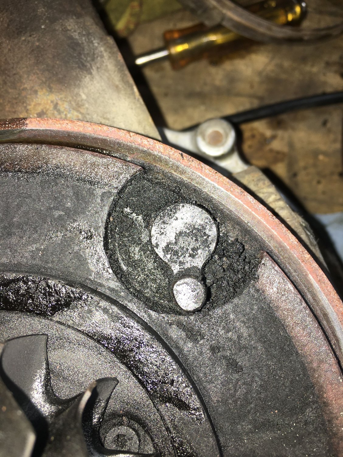

Also......have a look at these pics.....looks like my unison ring and lever pin are worn oblong???
suggestions?

Bad news is you're going to need a turbo. As far as I know they don't sell a kit with the lever in it. And the oil seal is blown underneath the exhaust wheel. The solenoid is most likely ok.

Yup, that turbo is done. you might be able to find another used turbo to get parts from but it might be worth wile to just get a new turbo from KC turbo or something.

Well that's handy having another turbo. If it were me I would rebuild the extra turbo you have with a new 360 bearing kit and clean the unison ring or replace it and call it done.
