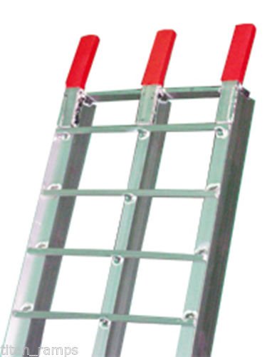

I see a lot of bed ramp offerings on other websites, and some have elongated tabs sort of like this one https://images-na.ssl-images-amazon....1jjOkCLaZL.jpg though the red appears to be some sort of plastic cover over the aluminum. Does a bed ramp with these sort of elongations even secure to anything on the truck? or do they just rest there?

The ramps I've used in the past just rest on the tailgate. But I've used them on trucks that were a lot lower than my F250. I'm not sure I have the nerve to drive something up ramps into the back of the F250! I would probably buy or rent a trailer.

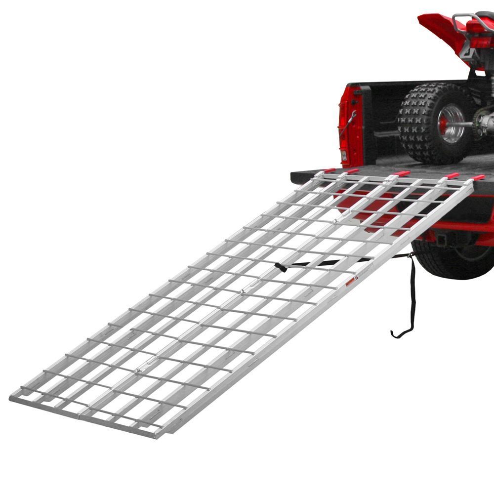

When loading/unloading my dirt bike I strap the ramp to my trailer hitch, similar to the picture below, however I hook to the holes where safety chains attach.

This!!! Do not ever attempt to load an ATV, motorcycle etc. without first securing the safety strap(s). Too many stories of ramps getting kicked out from a rear tire spinning and the machine coming back over on top of the rider, either killing them, paralyzing them or other serious bodily injury.
With what you are wanting to load, you will also want to make sure your angle of approach from your ramp to the bed is not too sharp so that when your front wheels breach over into the bed you get high centered and stuck. That is a very precarious position to be in.
The best option would be to rent a small utility trailer with the ramp on the back.

CACRanger, I like that idea, do you have a ramp like the example picture you linked?
Most of the ramps for sale seem to be the two separate tracks. Wondering how to secure that.
WyoBull, "angle of approach": Is that why some of the ramps for sale are arched?
I actually have a few different ramps.
I usually use my narrow ramp like this for my dirt bike since it is light.
I also have one of these for when I am loading multiple bikes OR an ATV. This is what would likely work best for you. Only reason I don't use it more is that it is heavier AND bulkier.
Hope this helps.
