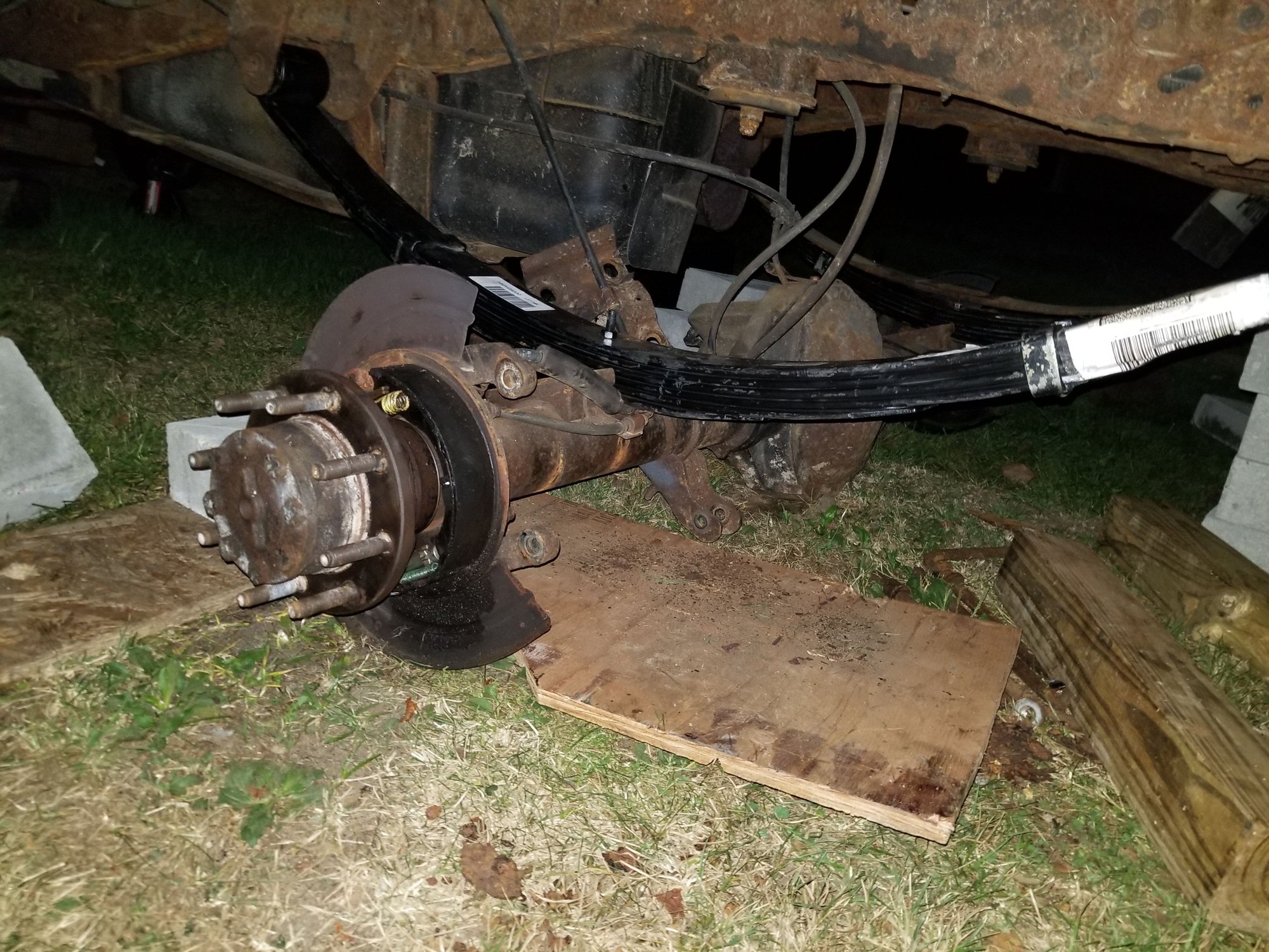

Hey Guys,
Recently bought a 2005 F250 4x4 super duty with a 5.4, auto and dump body. When I bought it I saw that it had that leaves that cracked and broke on each side of the rear spring packs. Wanting to get this thing road worthy I bought two Procomp 22415 rear leaf springs. I believe these are supposed to give you a 4 inch lift or so, but I mainly needed cheap springs in good shape.
My current issue is I believe the springs may be on the truck backwards. I tried them mounted with the shorter side from the middle spring bolt toward the front but it seemed the drive shaft was getting pinched and there was little to no slack to get the springs into the right position to put the ubolts on the axle. It also seemed like the axle pumpkin was sitting too low to the ground, though this may have been because I hadn't discovered the best way to raise it up with the jack at this point.
After swapping the springs around so the longer side from the center spring bolt is facing the front of the truck I was able to get the ubolts in and the axle mounted and wheels on. However the problem with this is that the drive shaft slipped out of the downward joint near the transmission when pulled the axle back in position to get the ubolts on the springs. After the tires were back in I went to try to connect the driveshaft at that joint (slip yolk?) and discovered instead of it being pinched it was about 4-6 inches too short of making the connection. After measuring the difference between flipping the springs the other way it seems that measurement would make up the difference.. so this all leads me to believe I had the springs in right the first time and I should have disconnected the drive shaft at that joint then installed the axle then used a jack underneath the installed axle to push up on the springs and get the drive shaft back connected.
I also noticed that the factory bump stops are much more aligned when the springs are positioned the way I had them the first time. Now the are about the distance that the drive shaft is short from reaching the spring center bolt.

what do you guys think? Sorry for all the rambling it's been driving me a bit crazy lol
springs mounted short side first the way I had them originally

yes the short end of the spring is the front end. You may also have drive line angle problems with the new springs if they are a 4" lift and the rear of your truck will sit extremely high compared to the front You will also need different rear shocks and possibly a new rubber brake line from the frame to the axle. The truck will quite possibly drive strangely as well.

are you using leaf spring hangers on the rear mount....that would give you horizontal adjustment control...the hangers come with multiple holes....using a lower hole moves that axle forward.....using a higher hole moves the axle to the rear.

A 4 inch spring will change pinion angle for sure. It may also effect length of driveshaft.
Only way to fix pinion angle is use a wedge between axle If they do that other wise you need to cut spring perches off axle rotate axle to correct position and weld them back in place. Not sure how 4x4 shops do this because my truck isnt lifted. I do know if pi9nion angle isnt correct you will have driveline issues.

You could have used the pro comps like you had originally. I see you removed the factory kift block so all you needed was a ten dollar degree shim to get the driveshaft back in proper angle
