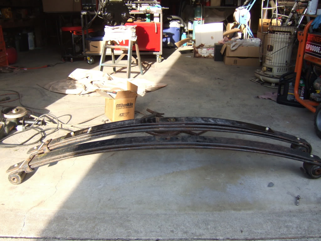

I don't know if it work out the same with the longer late model rear springs, but I took the single top overload leaf off my set of rear B codes and added it to my front leaf pack. The hardest part was drilling the two holes to add the two nylon slider pads to the ends of it.
Here is one front pack with the extra leaf added next to the other X code without.
