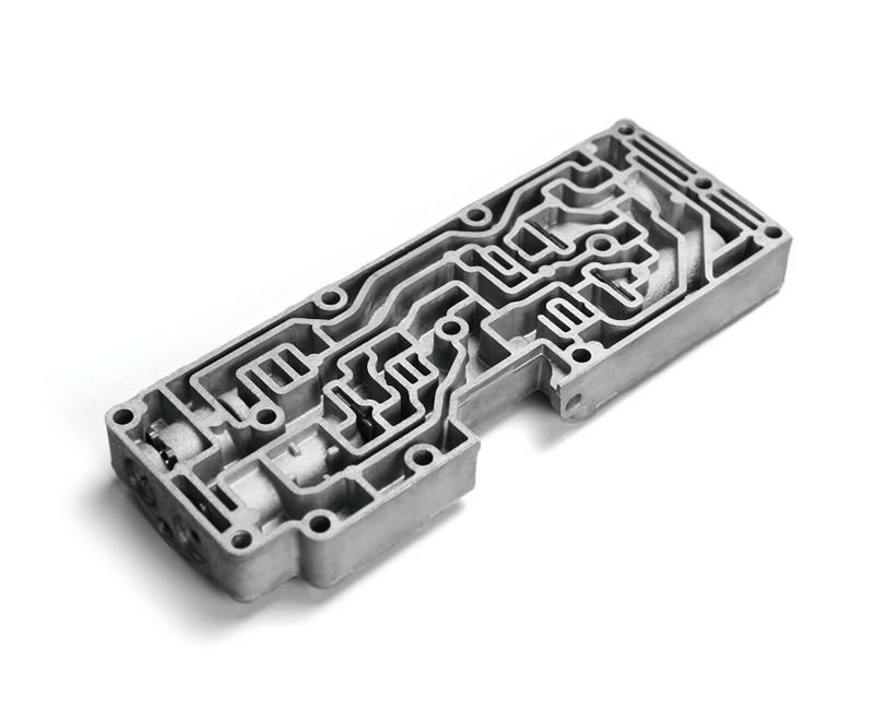

Factory Tech valve body
I posted this in transmissions section, but no answers after a few days. I have a Factory tech valve body for my 4r100 that I never put in. I was so long ago, that it is a signed unit with Greggs initials in sharpie on the side. He made it just for my Ex after I told him I wanted it for towing.
the trans is in good shape at 97k miles, but the front seal is going and dripping oil when hot and towing. Trans oil changed every 20k miles or so. So I have to drop the trans to change the seal, so I might as well install this thing. The Ex is primarily a tow vehicle, with only 10 - 15% or so for other running.
The question is whether the Factory tech body is as good as the new shift kits they have nowadays.. You think I should go ahead and install it or get a newer kit to update it with?

Nope, install it and go.
Gregg was a big presence on the L forums back in the day and his FTVB's were the shiz for the gas 4R100's. You can see in my sig what trans is in my L.
Put that puppy in and run it.

Is the VB swap as straight forward as unbolting the old and bolting up the new? Maybe dealing with a spring or 2 here and there, but pretty straight forward?

Very straightforward. Only a straight swap. Just make damn sure you use a inch/lb torque wrench on the bolts when you put the new one in and get the torque right. Too much or too little torque can warp the valve body enough to cause a sticky valve and then it causes major shift problems.
Yes, just make sure you unbolt and remove the correct valve body or you'll be chasing little plastic ***** after they slip out from the worm trails in the valve body.
The one you want to change doesn't have any plastic check ***** to worry about.
