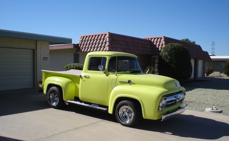

When I got my truck I wanted to lower it too. I have a 72 Torino 9" and a 70 LTD front clip.
I moved the rear axle above the leafs and got new front coil springs from Eaton Spring. I called them and told them what I wanted to do and they made up lowering springs for me.
I changed the wheels too...
Before:
After:
Your truck looks great! Good luck with it.

That's the stance I want
Before:
After:
I like the way that looks, great job. What size wheels?
Thanks, they are 18" 2005 Mustang wheels.
