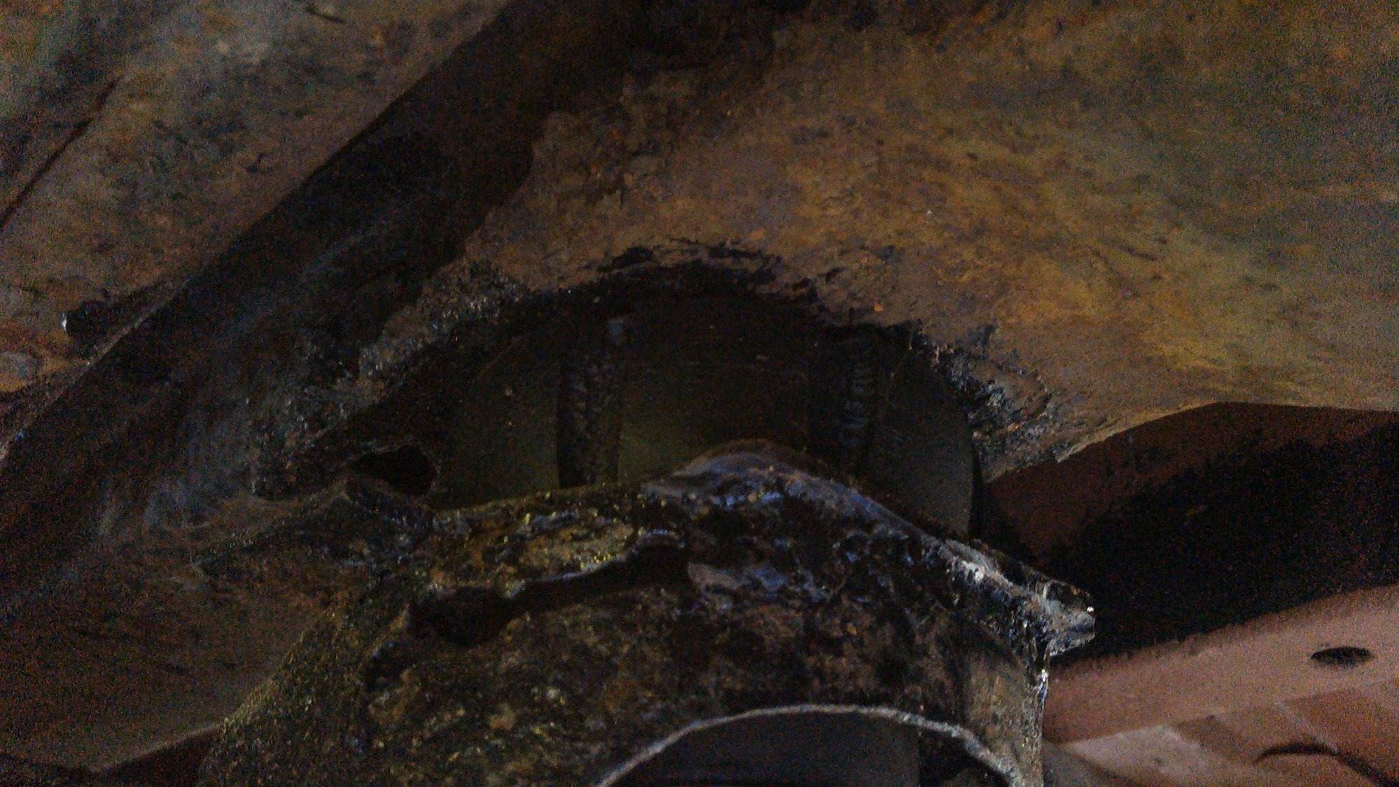

1978 f-250 4x4 supercab. I bought a a cab mount bushing kit from JBG. Apparently same kit for supercab and standard cab, no difference said the salesman. , fronts went in fine, no issues. I installed the rear, now the back of the cab sits 1/2 higher than the bed and the body lines don't align up! I didn't use a torque wrench I just cranked them down until they got really tight. Are supercab rear bushings different from standard cab bushings?
What did I do wrong? Thanks.

I could easily be wrong hail destroyer, but that frame mount looks like it's been "fixed" at some point in it's life. I thought they were all just the stamped pieces, but yours looks to have a plate welded to the top of it. Apparently to fix a rusted out mount.
It's very possible that when they did it with the crushed stock rubber cushions/insulators, the extra height was not an issue. But if they did add any height, this might be your explanation now that you have good full-height cushions.

I wonder if that's even applicable to the polyurethane mounts though? Completely different hardware design.
The steel retainers on the stock setup are designed to interact and literally compress/bind/mushroom together, which would act against the torque applied.
The poly bushings are (usually at least) just nuts, bolts and washers. If I'd tried to get 50 lbs out of the ones I did years ago they would have crushed way down.
Anyway, just use your own sense and do 50 if it'll reach that. But if not, and you see it start to squeeze the bushings down beyond where the stock ones would sit, stop and just let the locking nuts do their job.
So how tall were the stock ones when installed? I never measured mine first unfortunately.
