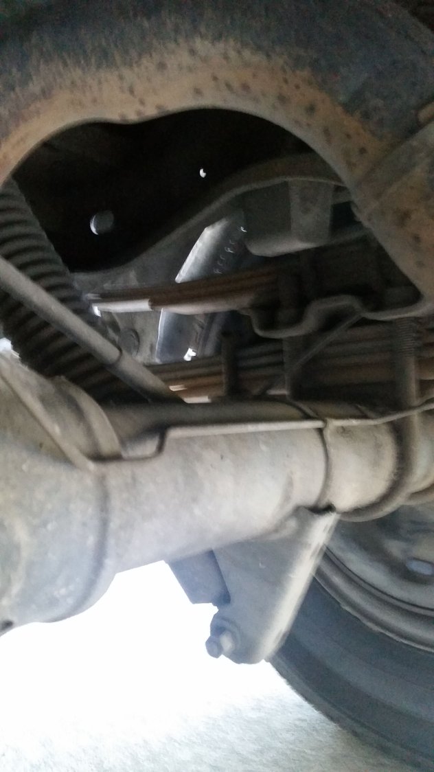

Just wondering about my leaf springs, are the supposed to be flat?
Ill take better pics tom. Has a set of overload springs. Cant remember brand. But leafs stay flat loaded or kinda empty.

You don't go by leaf shape, look at the bump stops between axle and frame, how much space between.

Is the Van sagging when empty? Some of these vans were equipped with springs that had a very low free arch but your spring is not one of those.
The fact that the van carries heavy carpet and has so many miles is a good indication that the springs are just tired.

There you have it, bump stop is right where it should be, no worry about worn leaves.

Those springs are pretty whooped looking. That top helper setup is acting like the muscle and not allowing the spring to go backwards anymore.

It looks like the original springs are shot and the only thing supporting the van are the helper springs.

The nice part of New springs besides increased handling and load carrying is the new bushings that come with them .
Helper spings seldom do once your springs are shot

The way the springs look in the pictures, they been shot for along time, and the add on helpers only covered the problem.
Hows this thing steer on a a windy day at highway speeds???
