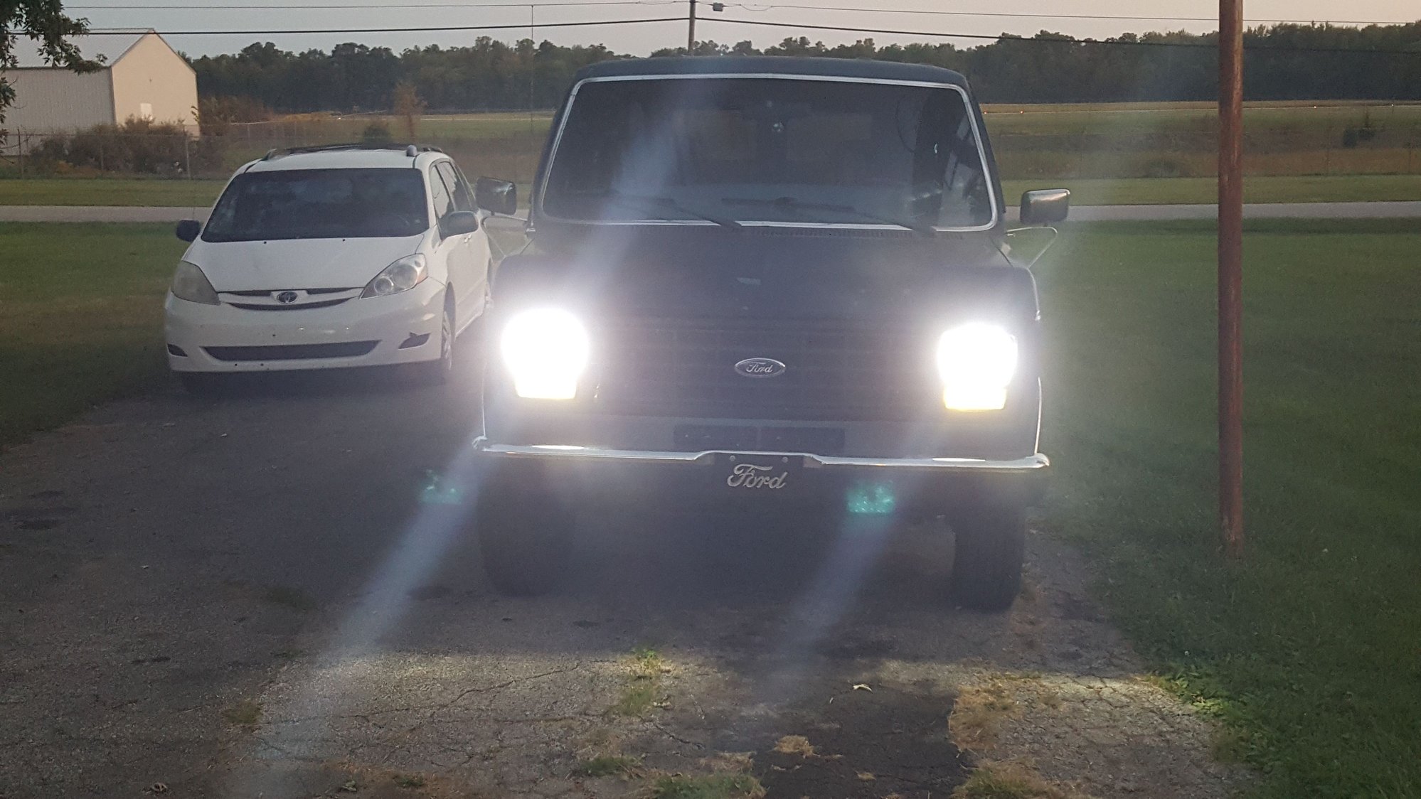

I got them installed in the housing and installed one in the drivers side for comparison.

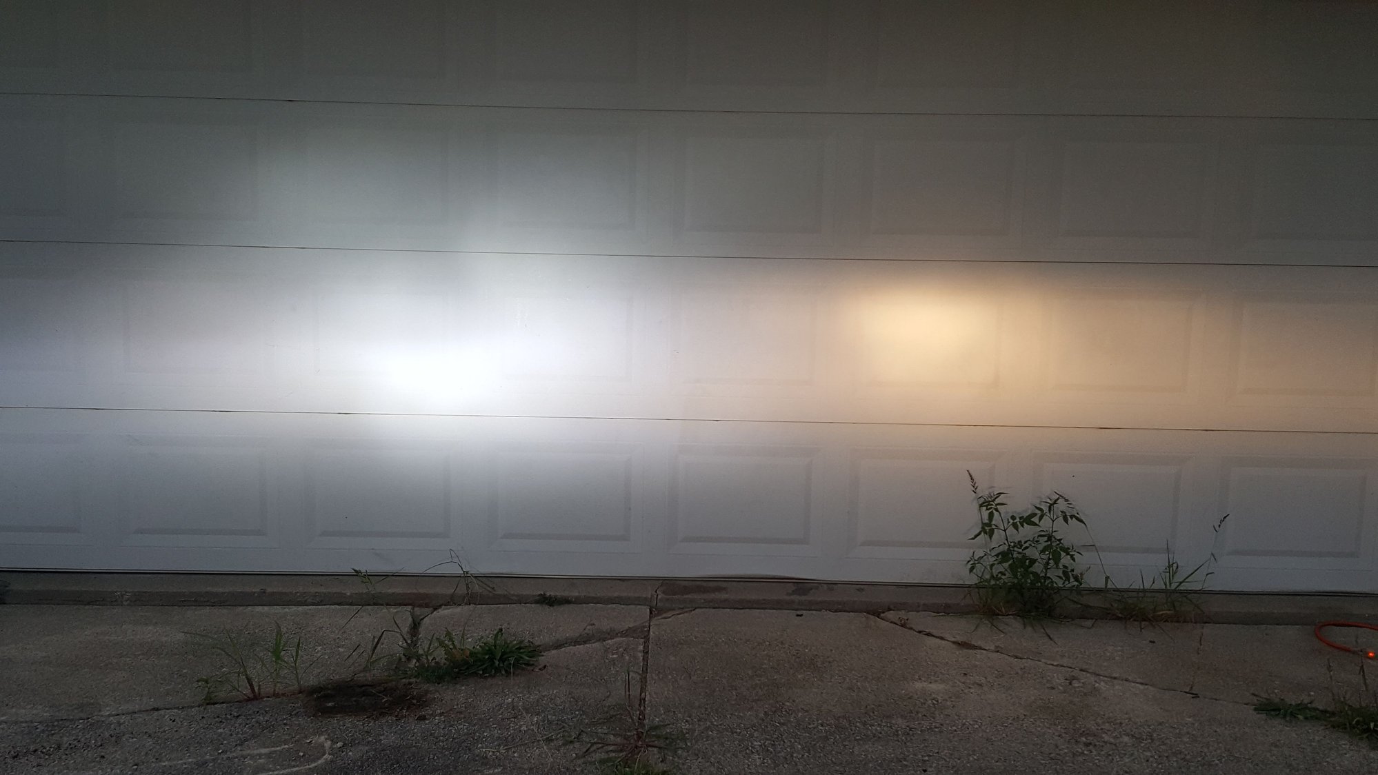

There seems to be quite a difference in light out put. It wasn't quite dark yet, but you can still tell.
Low beams
High Beams
Low Beam light spread
High beam light spread

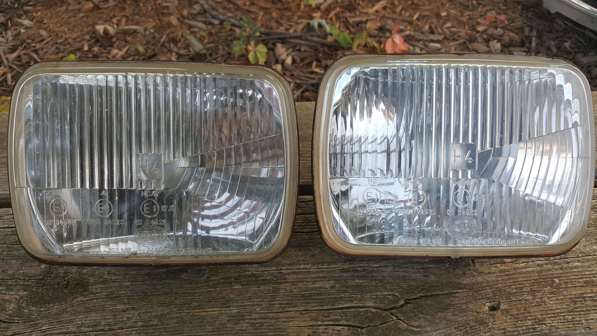

Here is a shot of the lenses. I am assuming the lens pattern on the front is to direct the light down and away from oncoming traffic.

Hella is a decent reflector, much better than any sealed beam for sure, but you'll never get it aimed right. With low beams aimed properly the high beams will send a lot of light high up in the trees and not where you need it. Cibie and Bosch have a better pattern, and Cibie is generally regarded as the best.
It's hard to tell from a camera but it looks like there is a lot of glare on low beams with those bulbs. This is dangerous as you're sending a lot of light at opposing traffic, into the eyes of the driver, blinding them. Adjust your headlights for a 4" drop at the cutoff from 25' away. Walk from at least 50' toward your van with low beams on after aiming and evaluate glare. If there is any glare, get some quality bulbs in there and it'll be eliminated. As far as I know no LED H4 bulb produces a well defined and acceptable beam pattern in a standard H4 reflector. Result is blinding other drivers and most likely less light on the road than a proper H4 bulb. The best performing H4 bulbs from my research are Philips Xtreme Vision and Osram Nightbreaker. I use the Philips Xtreme Vision in my truck and two bikes and am very pleased with the performance.

This morning was raining/overcast and I left right at sunrise (7:30). I noticed that the road signed were noticeably brighter/more reflective at a further distance than before. My biggest concern is blinding oncoming traffic, but I didn't have anyone flashing their brights at me and when I pulled up behind cars at stoplights I noticed my lights were hitting their trunk and not shining into their rear window. When I got to work a guy who arrived coming the opposite way at the same time said "Man, you got some really bright headlights on that van!". I told him that I just upgraded and was concerned about adjusting them so I didn't blind incoming traffic. He said that they weren't shining in his eyes and didn't bother him when he was coming the opposite way, they just caught his eye because they stood out as being brighter than the norm. Hopefully this means they are adjusted correctly. I am still planning on going through this process to make sure.

Good signs, all. And they're not too "ricer" blue? 6500 Kelvins is on the blue side. Could be they're really closer to 5000-5500, which is actually a good thing (closer to daylight).

Went for a drive on some dark country roads last night. The new headlights are a huge improvement over the stock sealed beams. It looks like they are pretty close to being adjusted right. They are angled down, but I am going to shift them slightly to the right. With the added distance on them the edge of the drivers side beam is on the center-line.....but not by much. I had a couple of cars pass me and no one flashed their brights at me or gave me the finger that I could tell.
Here is a pic that I took out my windshield of my low beams. There isn't a lot of difference with the high beams on except that it lights up the trees that are on the side and overhang the road more. Site distance seems to remain the same.
