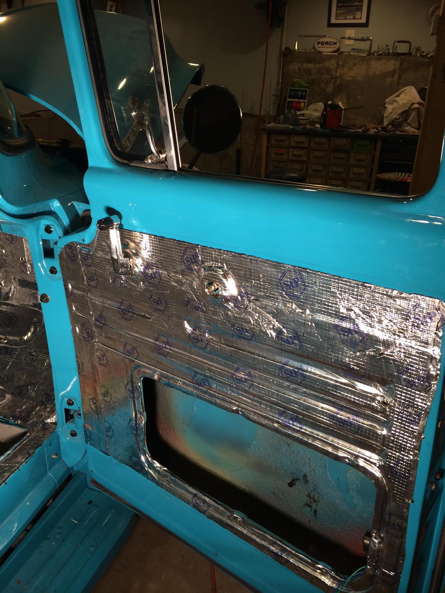

I lined the entire inside of my cab and it made a HUGE difference. The cab would start to resonate at idol and would almost start to howl. Trying to drive the truck for more than just a few hours was exhausting.
I lined pretty much every inch of the inside of the cab. Roof, floors, up the firewall, the underside of the dash. I even took out the tank and matted that. What a difference it made!

Mine is most certainly quiet enough for all of that now!

I used STP Sound Deadening. My friend is a re-seller.

Thanks for the pictures and info. I don't see anything inside your doors. Didn't you do the inside too?

Just went on the link you supplied but there is nothing called STP. Does Kilmer or Noico ring a bell? What thickness did you use 50 or 80 mils? About how much product did your truck cab take?
