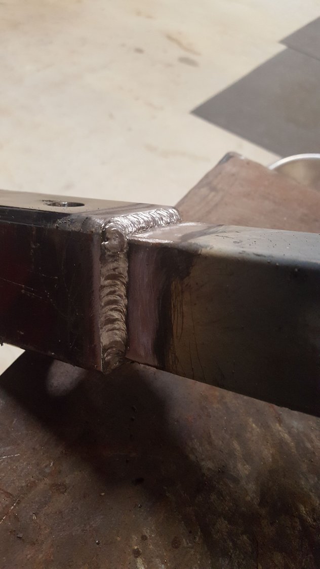

If you are a welder or know one you can make one ez. I made several, any large steel shop should have the components in stock, the tube and I would add on the lip to get an exact stop on the pin hole. The Ford design is just a straight tube and if you don't keep a pin in there all the time to hold it it will work its way out. Put a lip on it and it will only insert as far as the pin hole (you still need to keep a pin in) this keeps it all aligned.

I was looking for a 2.5" drop hitch one for my WDH. could not find anything. I got one from tractor supply, 2.5" to 2". OD was a very good fit, ID had to much play in it, I just welded it on the insert shank to keep it lined up and take the slop out. I think it was $12.99 if I remember right

Done same here, fired up the Miller built my own for a few bucks
