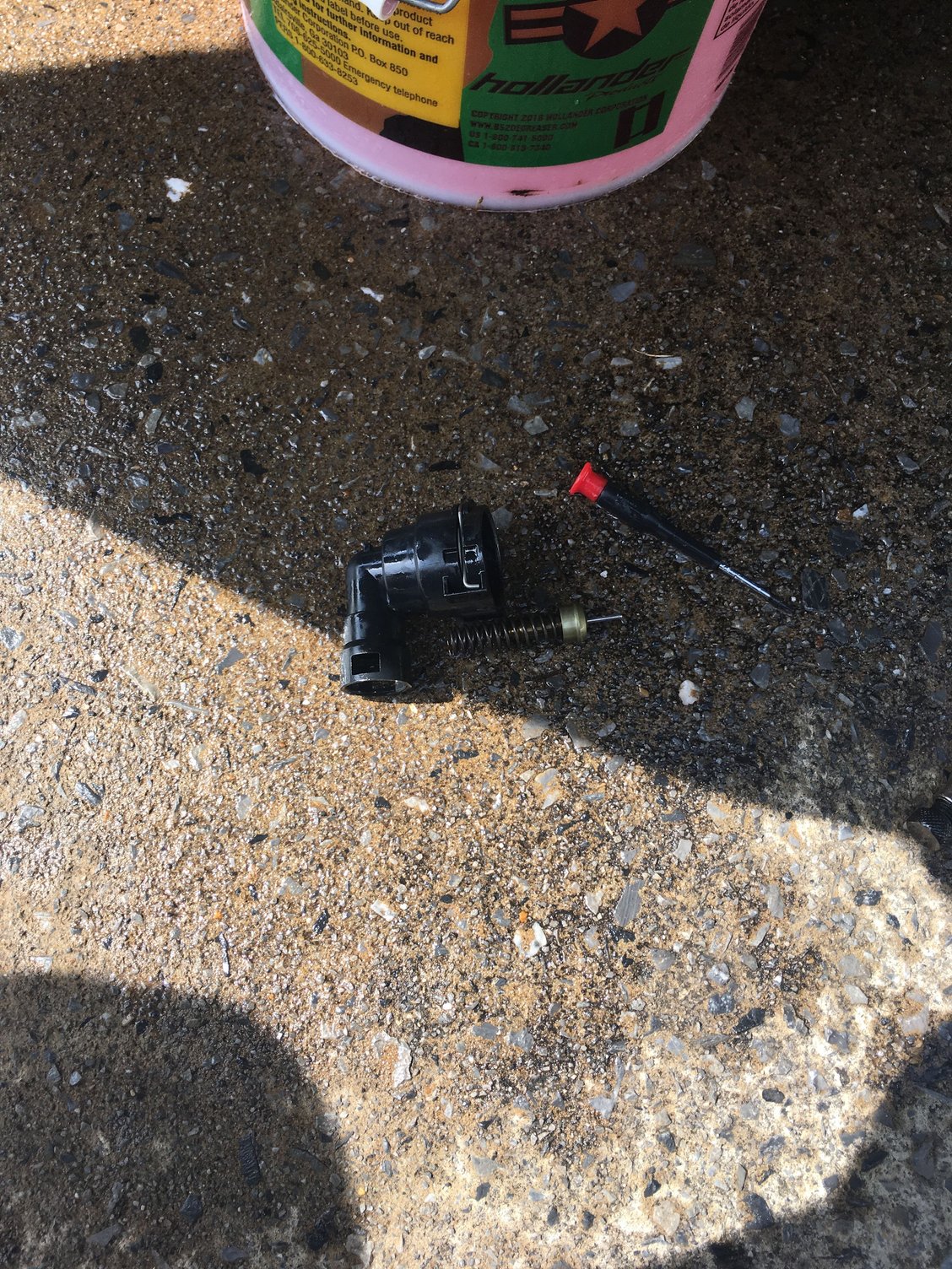

As most probably know, the trans, starting in 2017, is now cooled by the primary cooling system versus being cooled by the secondary cooling system like the 2011-2016 trucks. I've noticed mine likes to run a little warmer when towing. And now that I have tires and running a "hotter" tune, my average cruising temps are up 3-5* over what they used to sit at. Use to stay around 203-204. Now she sits around 207-208* running down the interstate.
I experimented with removing the thermostat inline at the trans cooler. The results? No change in temps. Just giving a heads up to those that hear about it and want to try it. No change in temps. I may figure out a way to convert the trans cooling back to the secondary system. Pics of location and what it looks like.

I think I would possibly like to make a correction on this. Maybe I had an air bubble or something. I know the system takes forever to burp, especially when you drain the entire primary system. I currently seeing an average of 4-5* cooler temps than I was before removing it. Maybe someone else can do this and report back.
