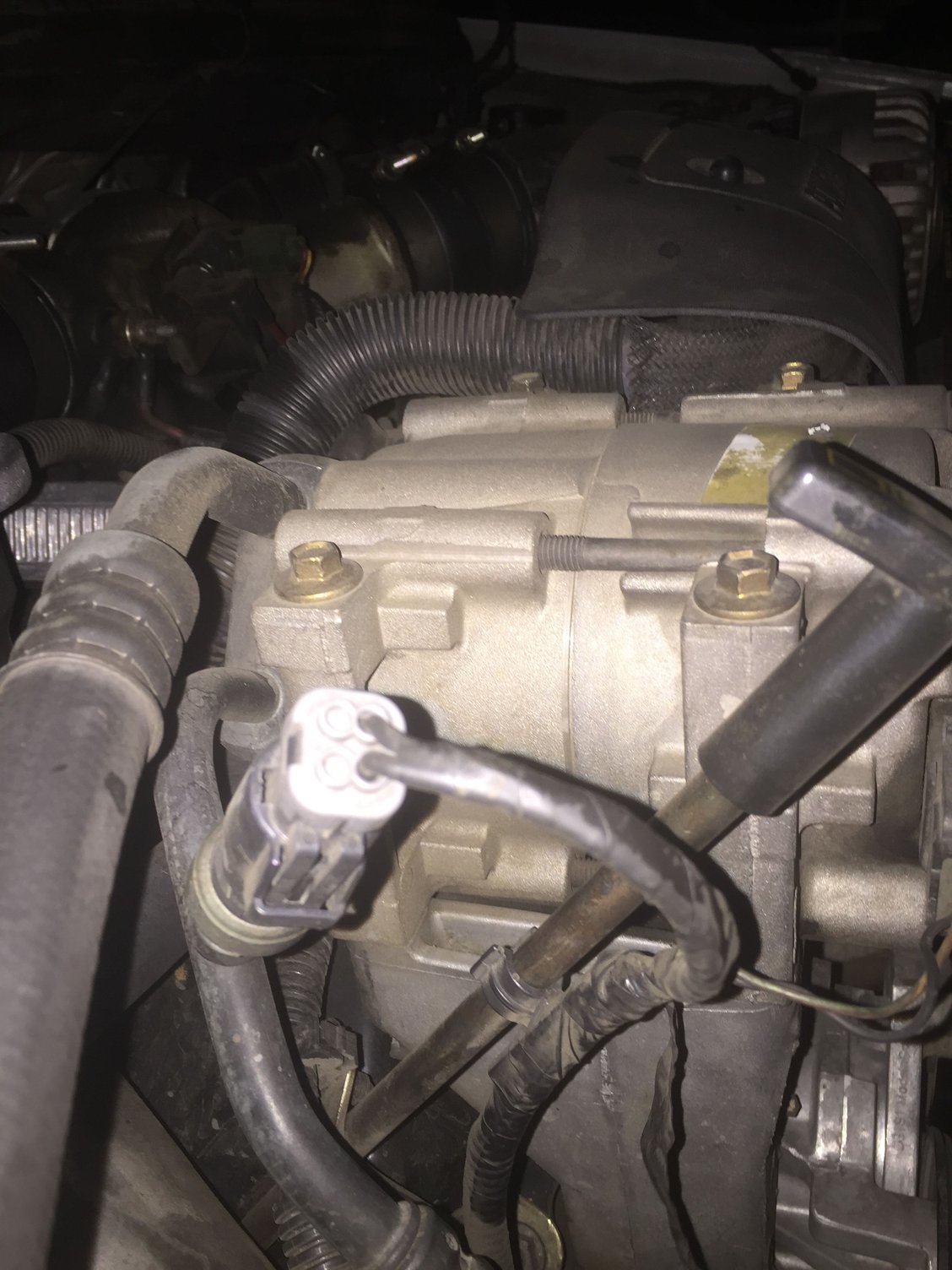

I had similar problem awhile back, it was those 2 wires sticking straight up from compressor and snaps on were broken. Can take a pic when sun comes up if you want

Hope that works for yuo. Couldnt wait until daybreak,sorry

btw, whatever thats called, I dunno as I`m no mechanic but thats those 2 wires. When I suddenly stopped blowing cold I would jump out and wiggle the wires and compressor would re-engage and blow cold again. I believe he also put a shim in somewhere. An A/C guru will probaly show up here shortly

I can't even see my compressor......but it sounds like what is going on . I hit a bump in the road and it starts blowing cold again...I'll have to wait til the rain stops and I'll crawl around and try to find it....Thanks......

Clutch field coil is where the wires go.
The shim would also be the clutch. You can check the air gap with
a set of feeler gauges and if it incorrect them you remove the
bolt and change the shims to fall within the air gap range.
This PDF has instructions on how to check and adjust the air gap.
