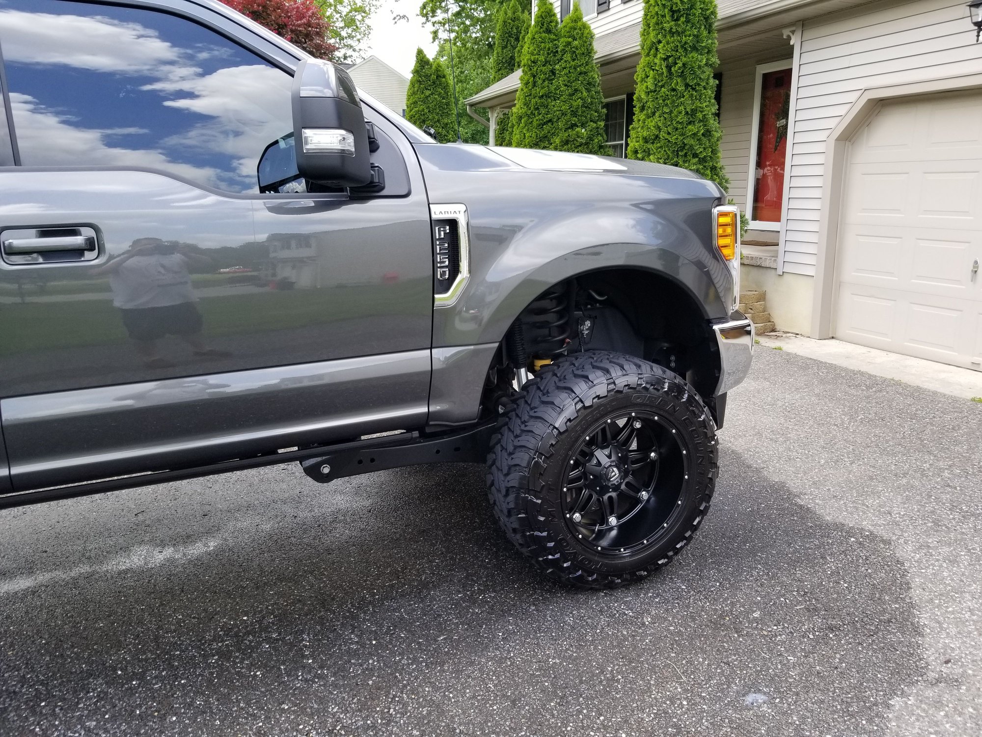

37s
I just got my 20x 9 0 offset SOTA offroad rehab wheels and 37x 12.5 NITTO ridge grapplers. I have a BDS 2" level, which put my truck (gas) with 1" high in the rear. I had 3.5" rake before level kit.
I had to a slight rub at rear corner of the fender. I trimmed the plastic tab and exposed the fender and then used a 2x4 to bend the corner over to give it some more clearance.
37" tires look bad ***. With my set up I should have gone with 35s so I didnt have to modify the fender but am real happy with how it looks.
With the 0 offset wheels I have 2" front and 1.75 stickout past the fenders so my next project will be the 1.75 bushwacker flares.

workingdan,
Your truck looks awesome! I'll trade you my 35's for your 37s

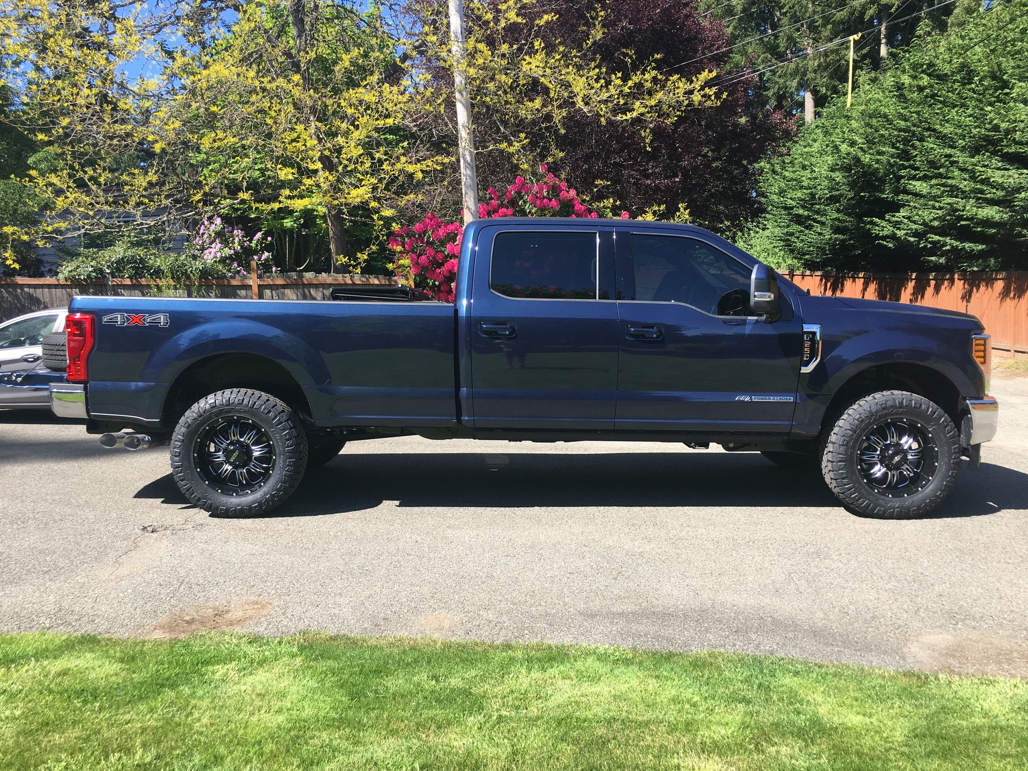

Nice truck. Mines kinda the same, but kinda different. 295/65/20 on 20x9 +12 and no lift.

Thanks
I am happy that I got the 37s. Just had to make a couple miner adjustments

Wow ya looks like a twin. Those wheels look real similar

Truck looks great. I am currently debating between the 35 or 37 on a 2019 with 6.2. Did you notice a big difference in power?

I have the 4.30 gears and I didn't notice much of a difference. I also have a 5 star tuner so that really makes a difference in seat of the pants power. If I had to do it over again, I would go with LT295/65R20 E ridge grapplers for a little more clearance at the lower fender. (I only have a 2" BDS level)
