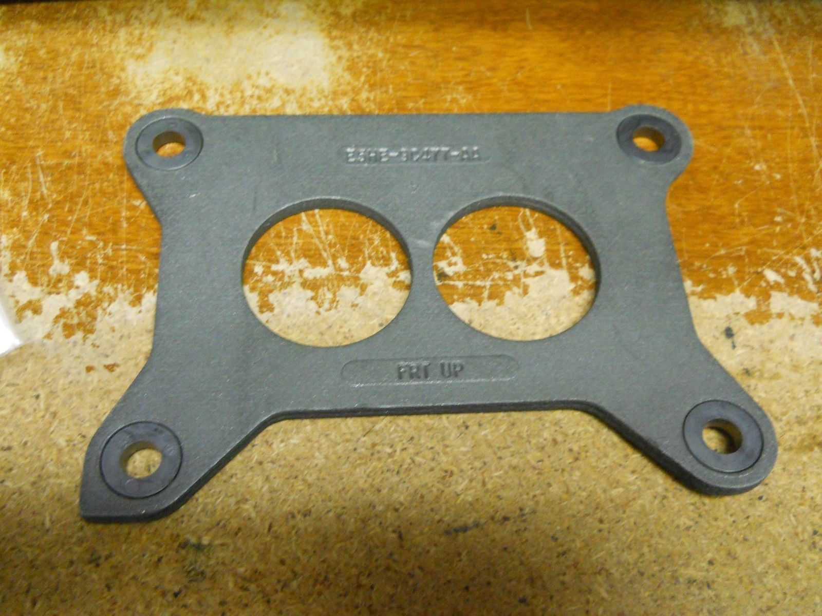

Part number E5SZ9A589A spacer.

Part number E5HZ9C477A.
I took out my spacer too. I replaced with these exact pieces. Working good so far. Haven't had to floor it to start yet but it's only been about a month.
Edit: I forgot to mention I also had re-route my PCV to the back of the carb.
