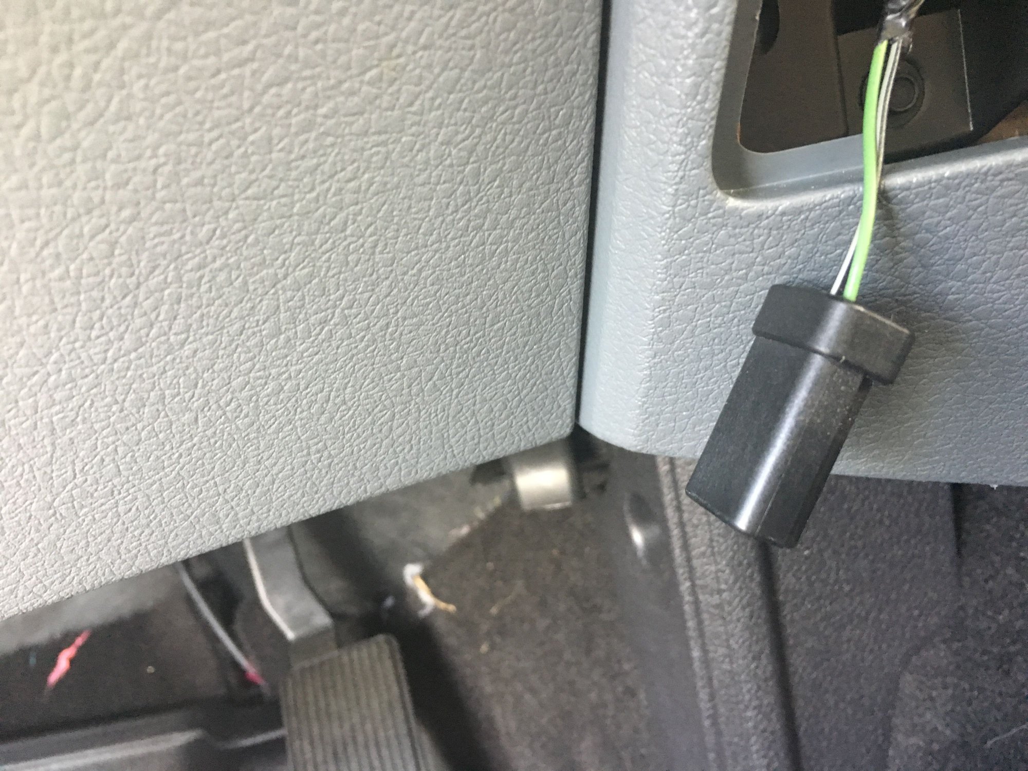

What is the electrical coonnector that is not plugged into a holder on the back side of the storage try at the drivers knew. Installed a new radio today and found it.

I recall it is for the F650 & larger trucks to allow the passenger side airbags to be disabled when no one is sitting there. There is a key switch those trucks have in that exact location. For the lighter duty trucks they just clip it into the back of the cubby so it doesnt rattle around.

That is thee connector for the air bag switch that is not installed on the DRW trucks since you have a rear seat for safety of pets or young passengers. Switch pn ix BC3Z14B268A.
