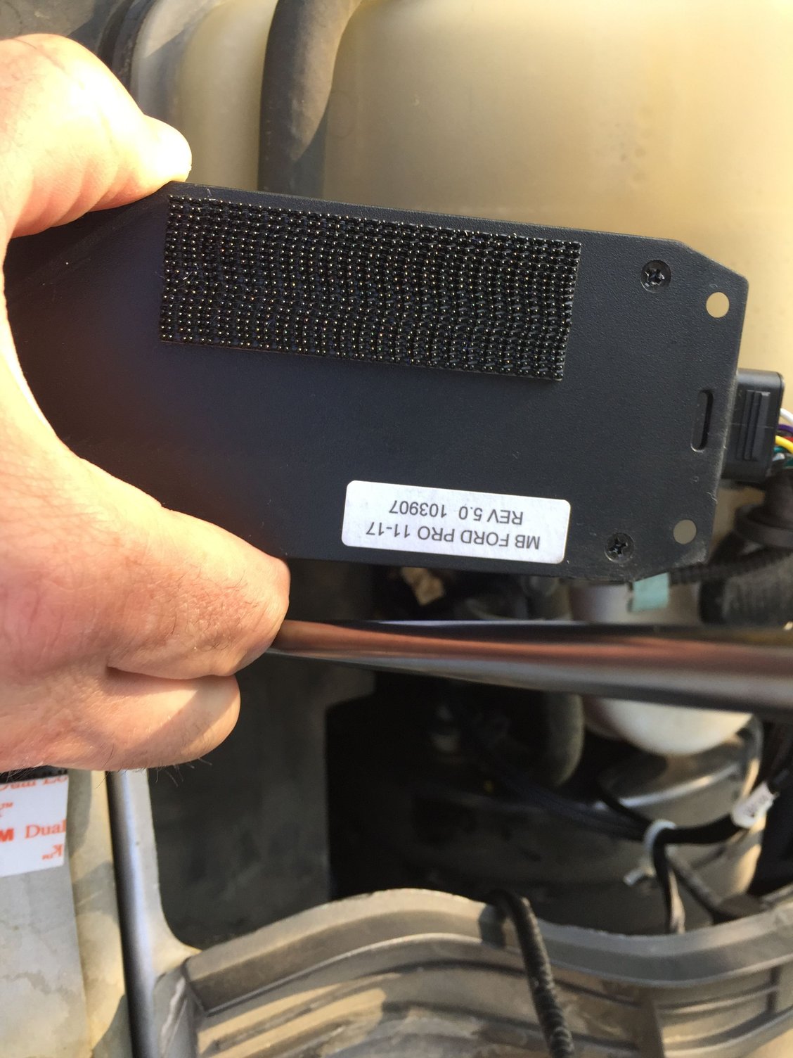

So a couple of days ago I finally bought a stealth module. I followed them on social media and figured why not. So I bought one. It showed up a few day later. Ill try and post photos of my experience. I test drove my truck and noticed a big difference. Highly recommend these mods. For those of you who live behind enemy lines or not in a free states this mod is perfect. It leaves no trace... Whenever you need to smog or take your truck to the dealer just pull the thing off. This is perfect of for owners who don't wanna void their warranty. This mod doesn't leave any trace..
[IMG]https://cimg5.ibsrv.net/gimg/www.ford-trucks.com-vbulletin/2000x1504/80-
img_5171_205ac3402e8a89bad30394ab8b7260f7eaecb59d. jpg[/IMG]

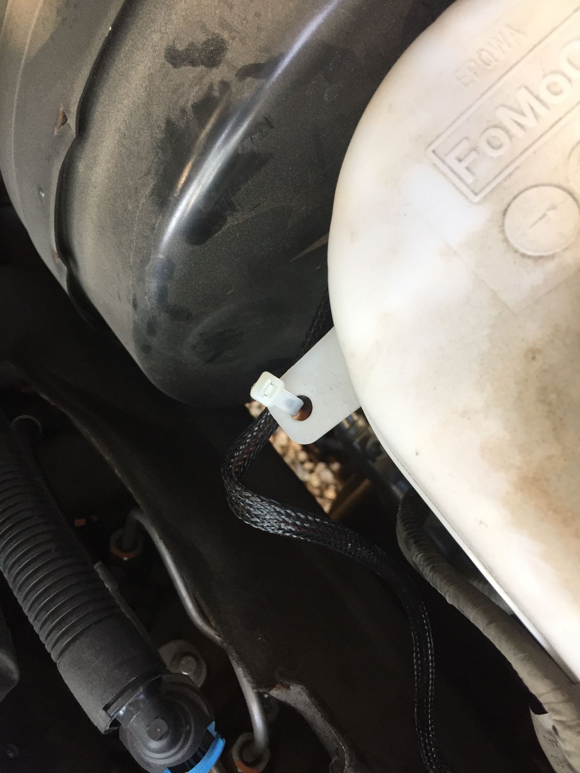

The contents of the box. I ordered the switch. It has 4 setting. stock, low, med and race.

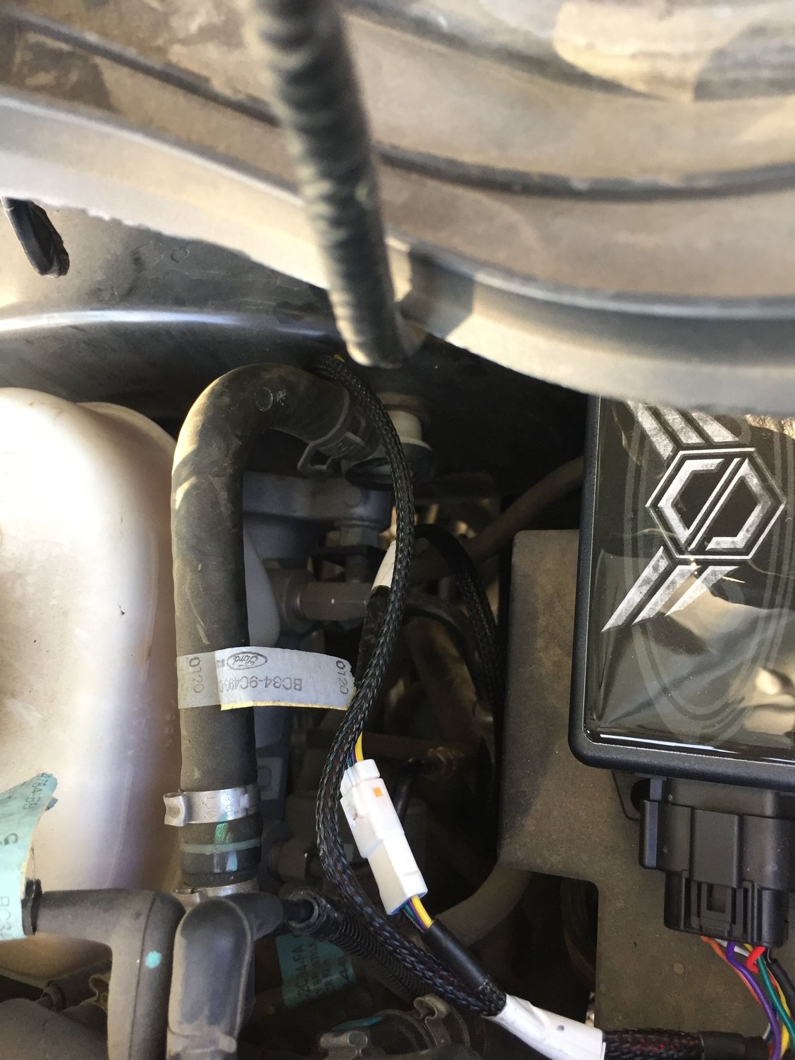

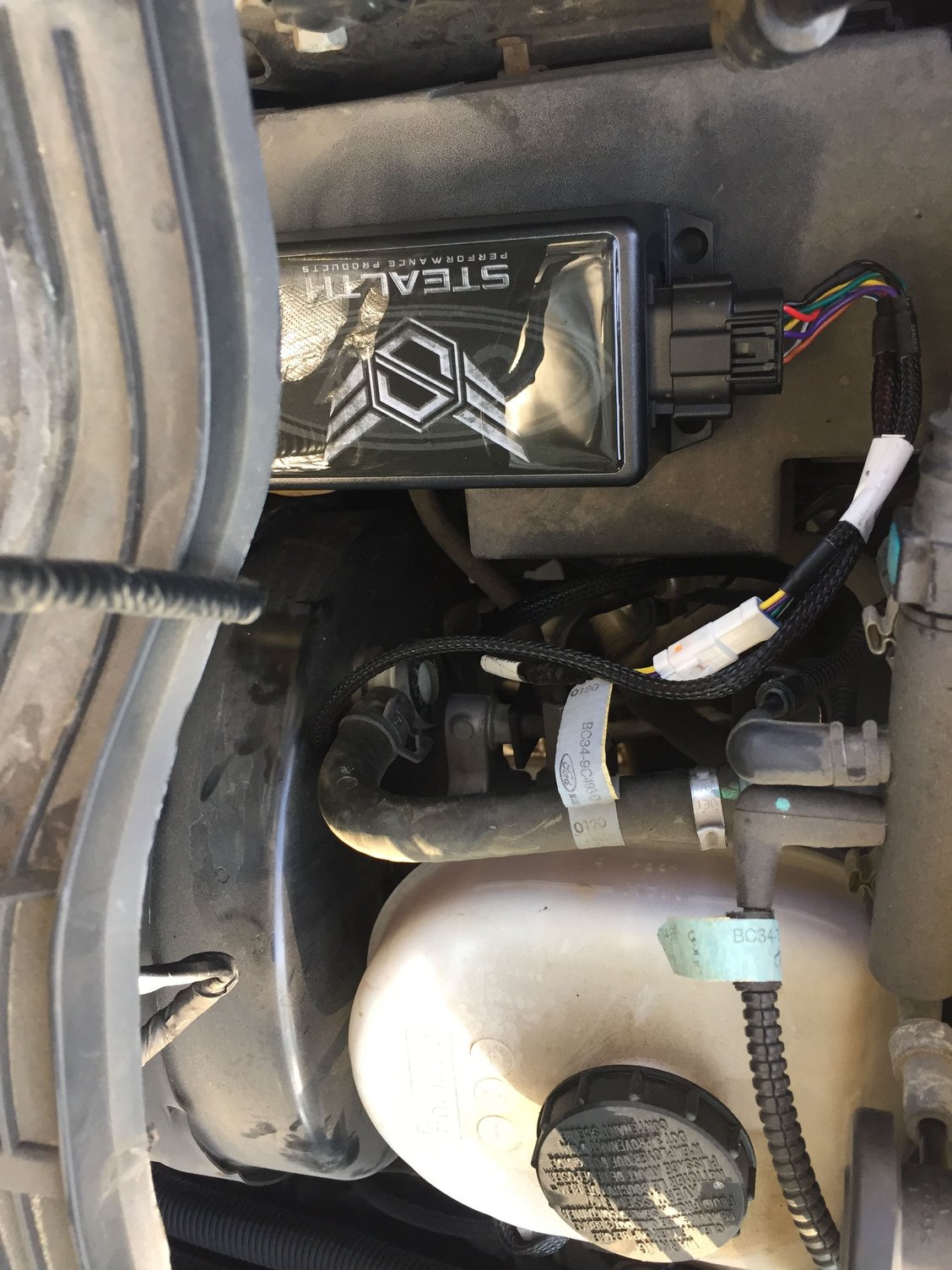

Finding the wires weren't hard but making sure you plugged them in the right way made the difference.
They recommend to run the wires away from hot objects. I did my best.

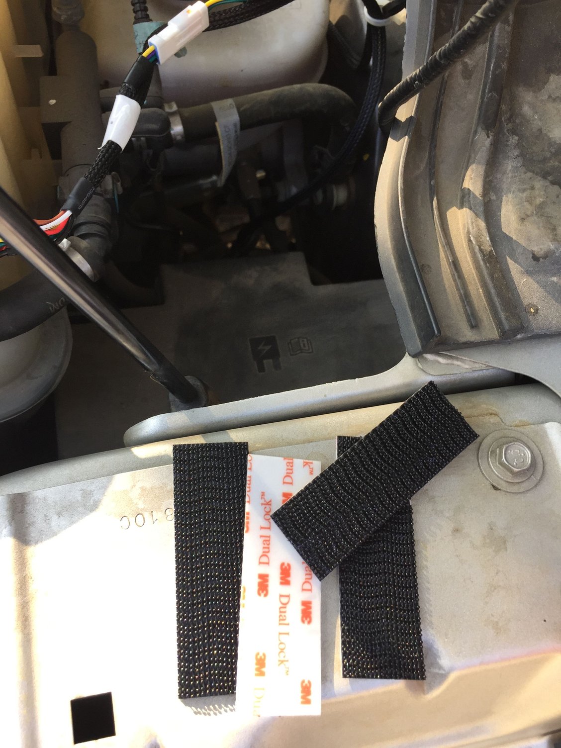

The Mod came with two black zip ties. I didn't use them. I decided to use 10lb velcro. The guy that makes them recommended this. Over all I think this is a improvement over zip ties.

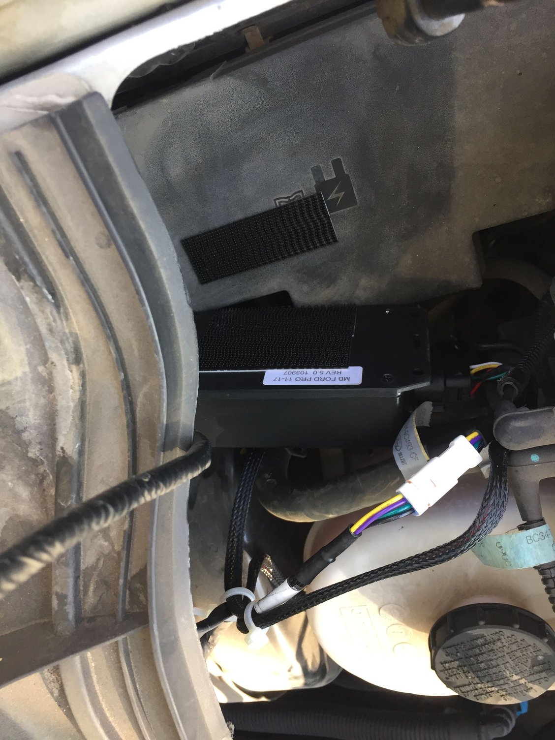

I mounted the Module on top of the fuse box. It was recommended by the rep that I communicated with. Away from heat.

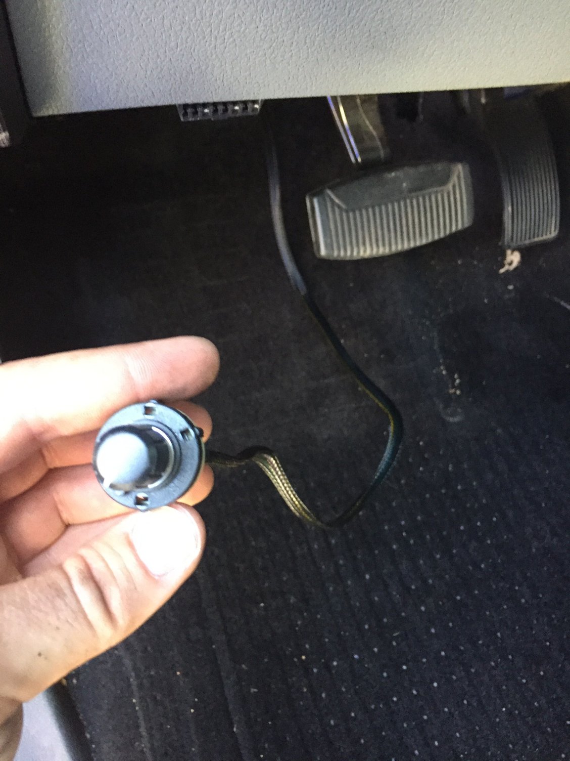

Feeding the wire through the fire wall took the longest. If you youtube how to pass wires through a 2011 f250 theres a guy that shows you where to access. Not very hard. All you have to do is pull up the carpet and pull the rubber plug. A trick that I used was that I drilled a hole into the plug and fed the selector out of the hole. I tied wire to it and pulled it up next to the fuse box. I did this so I didn't have to drill a larger hole for the selector.
This is the switch that came with the mod. I found a hallow spot above the parking park the install. I drilled a 11/32 hole *i think* it was a perfect fit. I pulled the side panel to the door and below the steering wheel to access. After I installed I took a couple of zip ties to hold the wire in place
This switch was too big to fit through the plastic plug so I drilled a hole and back fed this thing through the fire wall. NO big deal. Just tape and string.

Well after a few months I finally noticed better mileage. Im averaging 18mpg- 18.7 highway driving at 70MPH. I think I could get closer to 20MPG is I slowed down a bit. Thing that kills my economy is city driving. I average about 16 city give or take. No issues thus far. Very very happy with this product. I may have put the switch in a bad spot. I've bumped it a few times getting in and out of my truck with my knee. After Noticing the increase power I check the setting and find that its been changed.
