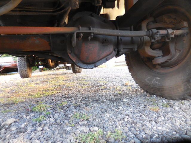

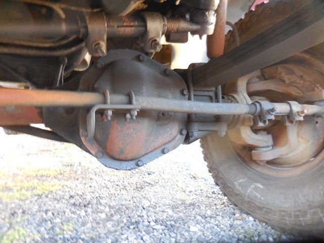

The housings look different.The 94 looks more conventional than the 95 I compared to mine

You didn't say, but is your '94 an F250? It'll have a TTB front end which is in no way, shape, or form stronger than a solid Dana 60.

My 94 is an F-350

That looks like a ball joint Dana 60. The older ones had kingpins, I can't remember when they changed to ball joints...

91 and older is kingpins. 92 and newer is ball joints.

This is similar to the front differential I saw on the 95 f-350 I was comparing my 94 f-350 to is this a Dana 50 and did they also come stock in 95 and
newer f-350's or did it likelycome out of a f-250?

That last pic is of a TTB, so either the truck is not an F350, or the axle's been downgraded.
