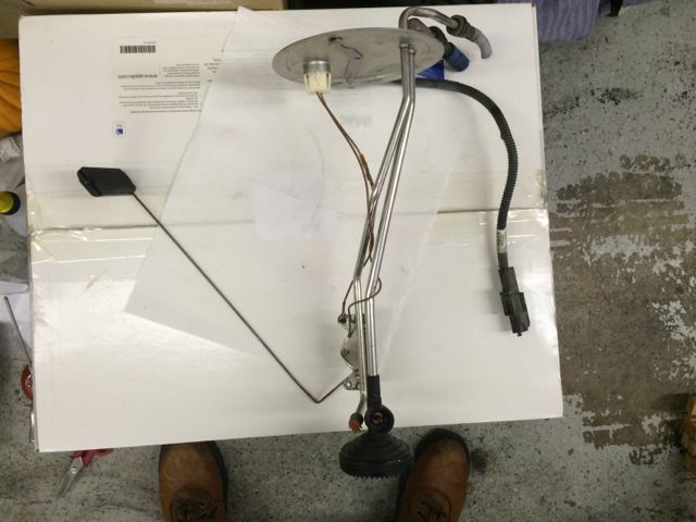

I have a photo of a level sensor that is just like what you will find in the tank.
BTW there is not any pump in the tank. Just the sender ,float and the suction
foot that has 2 valves.

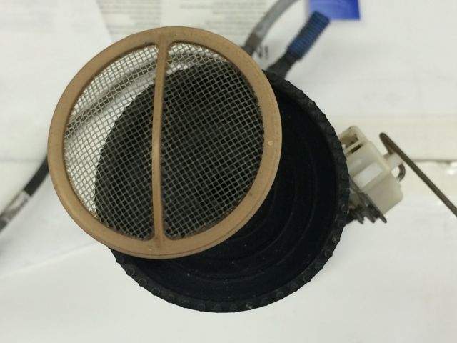

This is what the sender will look like when you remove it. It's a good idea to replace that green seal
and it's only about $18. That will help to keep the tank from weeping when filled up. You can also
do the Harpoon mod while you have the tank open. Lets you fill it higher and faster.

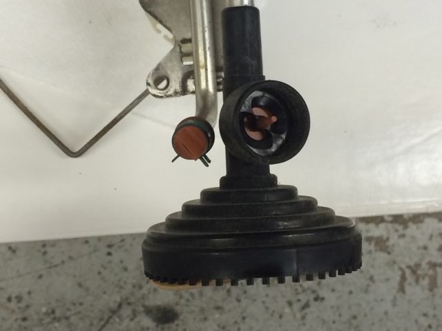

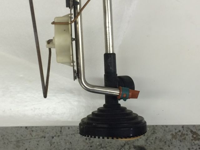

Here is a good shot of the 2 valves. The one is the return to tank line and that helps the pump
from pulling air in as the fuel gets low. The other is a suction relief valve so that if the screen
on the foot gets plugged with junk in the tank you can still get fuel to the pump. The down side
is if your low on fuel it will pull air in.
Almost forgot the screen on the foot. If there is any question when your going into the tank you can always
replace the foot assembly that way you know that the parts have not gotten hard from age.
