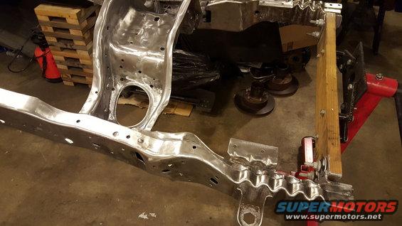

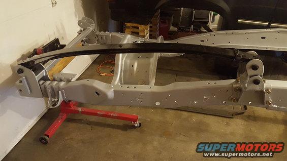

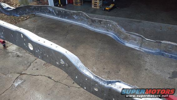

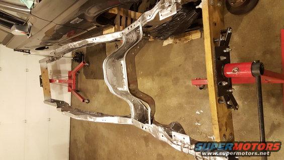

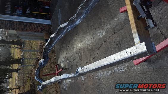

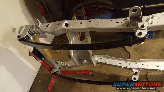

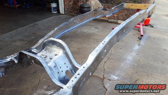

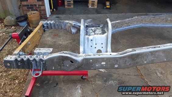

I'm using Rust Bullet on my build. Word of advice, read the instructions and follow them carefully. If you are applying to bare metal, buy and use the metal blast product they sell according to instructions.
I had to re-do my frame and axle a second time because I didn't follow instructions and the coating just peeled off like aluminum foil.
After following instructions it cured hard as a rock. I can take a wire wheel to it and it will not penetrate.
Bare Metal:
Etching w/ Metal Blast:
Coated:
