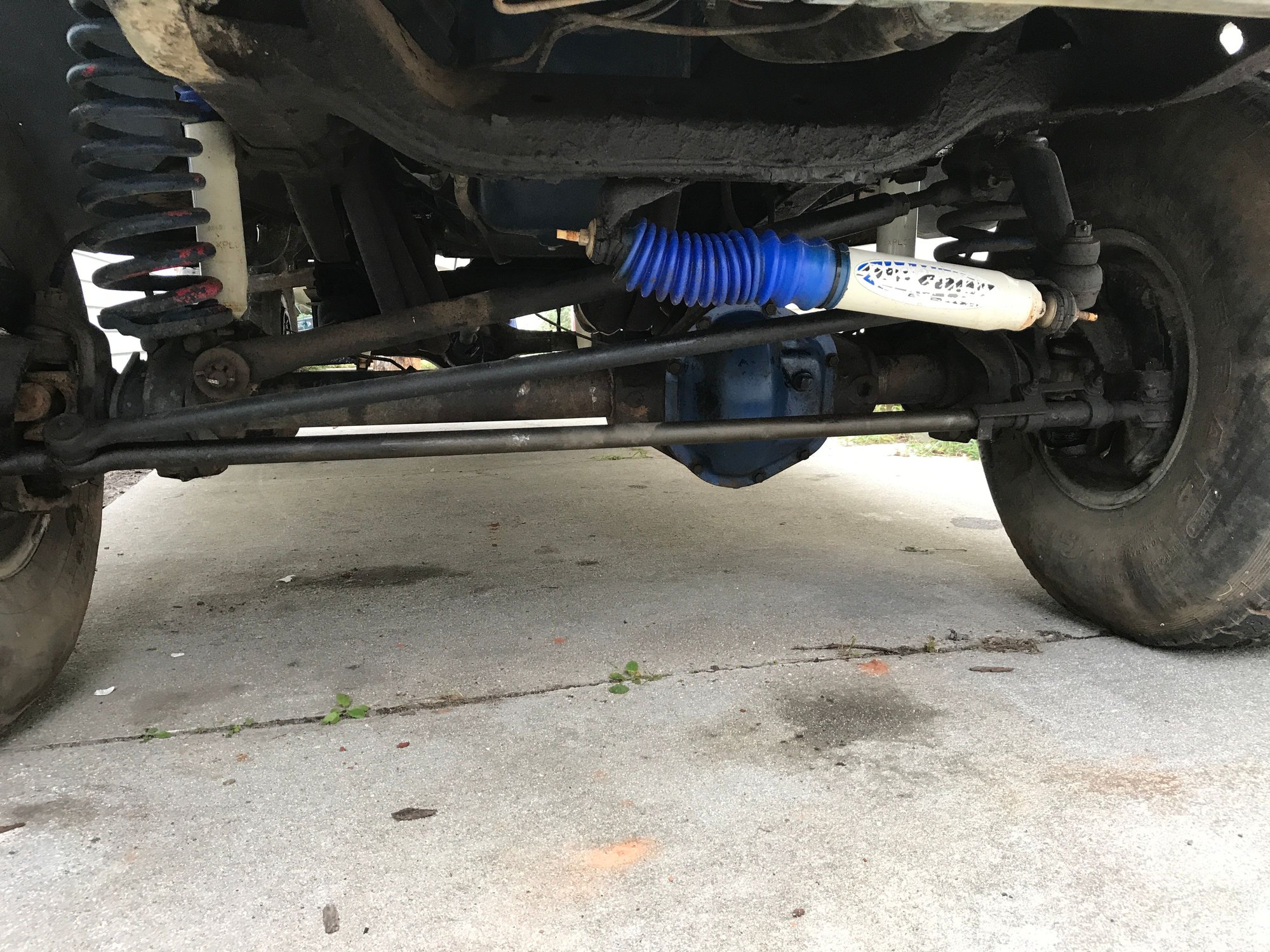

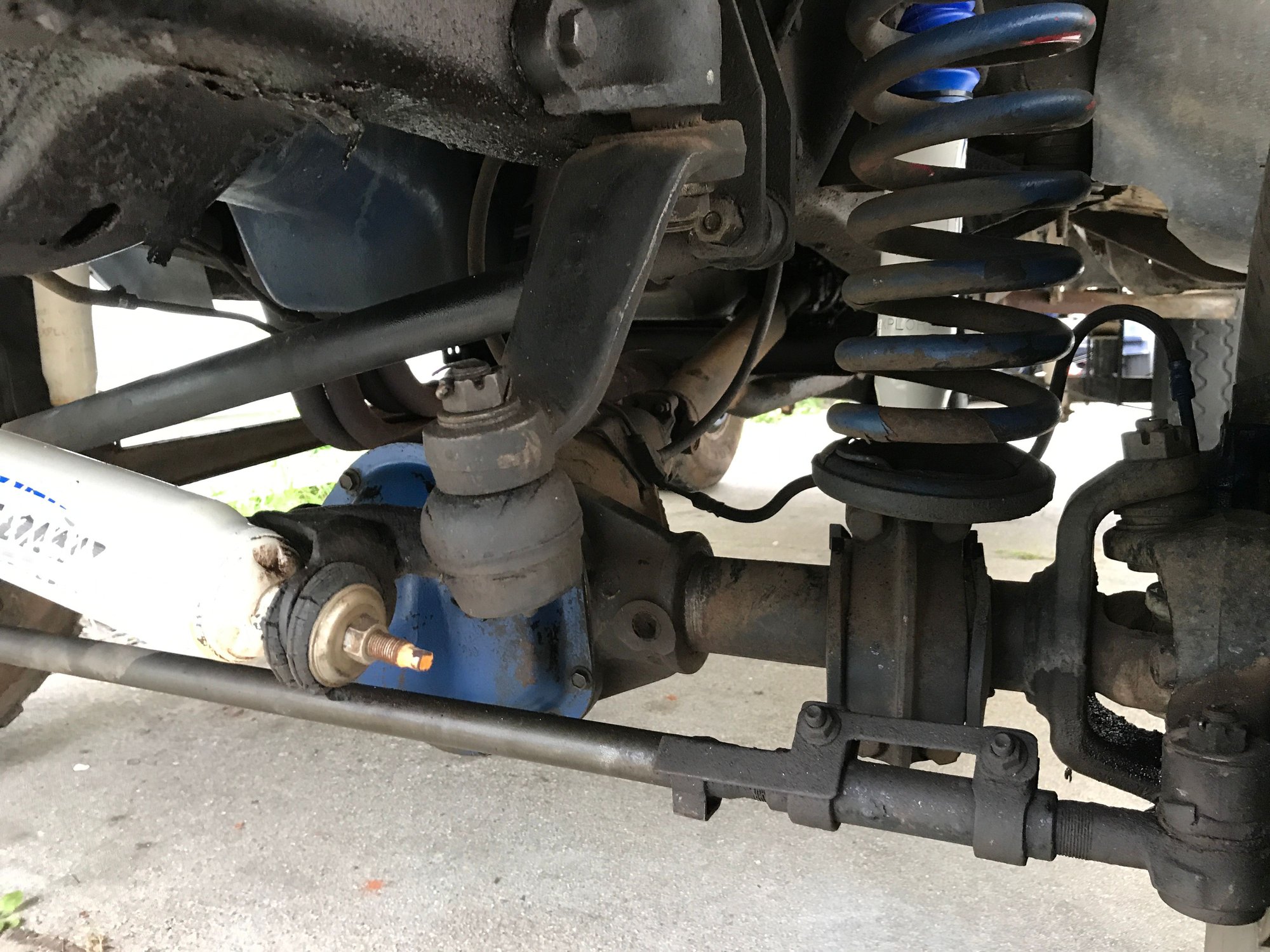

Here are the pictures of the front end. Please let me know what looks wrong, what is wrong, or what y'all think I should fix...or do to make it right.

Well there's your problem right there... A couple at least.
First, you have a dropped pitman arm without the associated dropped trackbar bracket.
Second, your upper trackbar bolt looks like it's loose. Notice the area that's been wiped of gunk. That makes it appear that the trackbar is able to move side-to-side. Which it's not supposed to do at all.
And though we can't tell from a pic, it's a very common thing for the lower trackbar stud/bolt to have wobbled out it's hole over the years and also cause lots of movement.
With a trackbar, even just a little movement equates to a noticeable amount of wandering down the road.
Also, is your axle actually centered? Good that it's got an adjustable trackbar, but was it adjusted to center the axle? If you still have the original you can use that as a guide and make sure that your new bar is longer by about half an inch at least. With your taller lift, it's likely going to be more along the lines of an inch and a half.
But only you can tell through measurements taken on your vehicle at it's natural ride height.
Are you sure that's a 6" lift too? I see the red springs, but your draglink angle doesn't look that steep considering the amount of lift it's supposed to have.
A very important aspect is those angles. The draglink and trackbar should be kept as flat as is possible, and both should be as parallel to each other as is possible too.
That means that whenever a dropped arm is installed, a dropped bracket (or riser if called for) MUST be installed as well, to keep things parallel.
But loose is loose, so anything that's loose works with the steeper angles and offset axle to cause steering to be very vague.
Not to mention that at this stage your steering box could be worn out as well.

1TonBasecamp- thanks for the reply...I loaded some more pics of the suspension. The rear blocks are 4 3/4" tall...howevever I thought the springs were either re-arched or more were added. That is where I got the 6" lift. But I could very well be mistaken. This could only be a 4" lift. What do you think? Also, does this change any of your earlier statements?
Also, the trackbar has 2 nuts on it, as seen in this pictures.

Is it me or does it look like pinion is pointing oftly high? Is it possible the offset bushings were put in wrong? That would affect the caster
