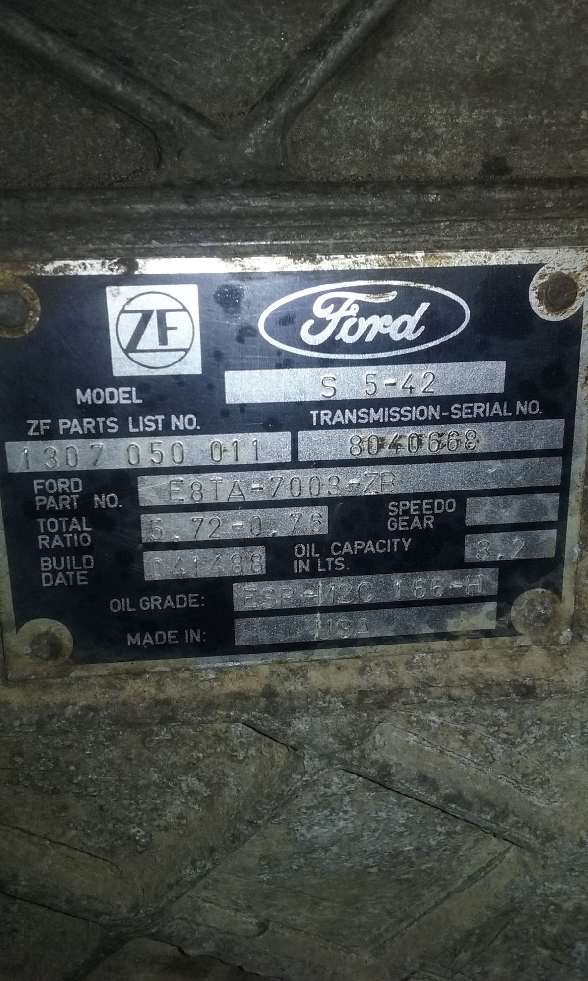

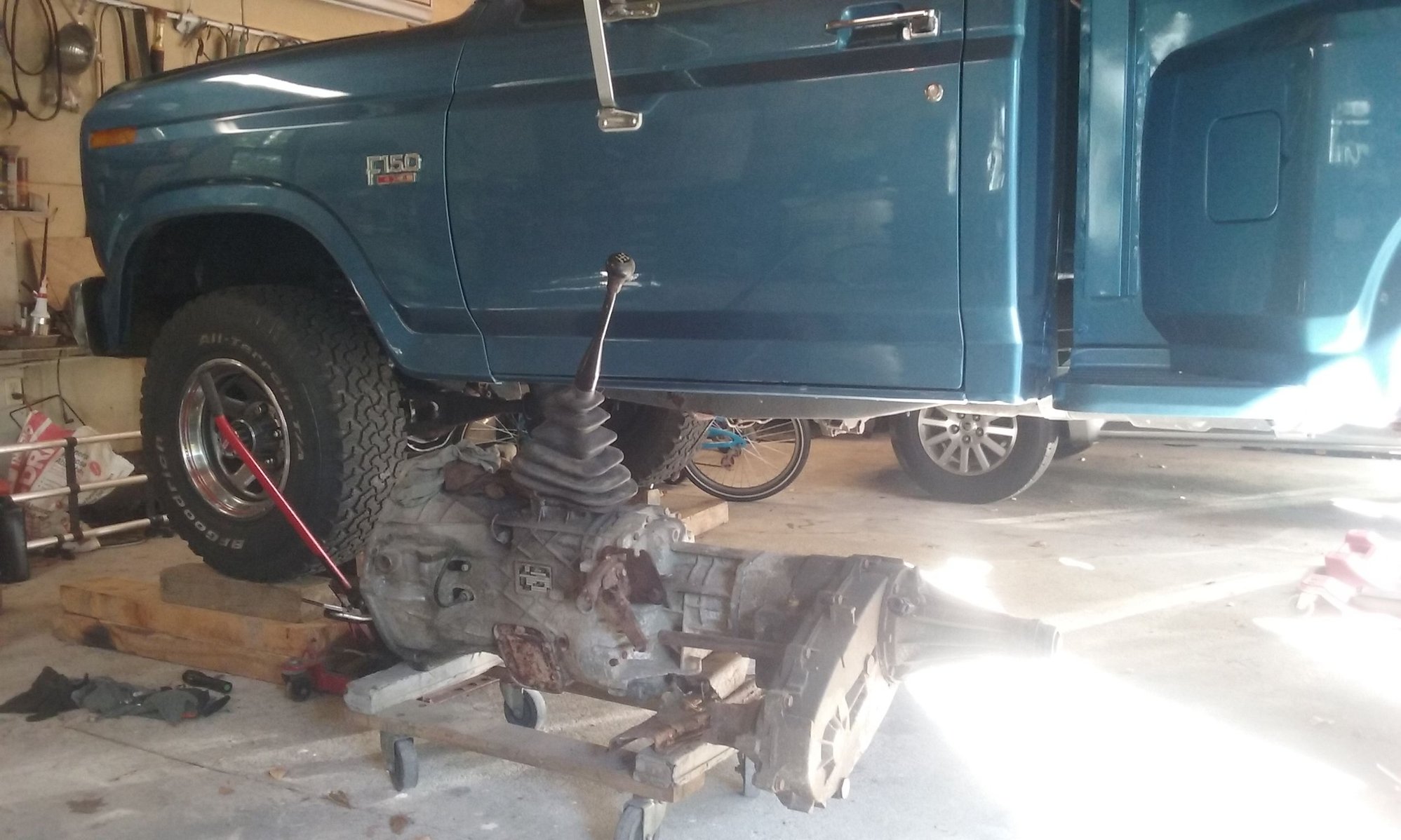

ZF-5, ZF-5, ZF-5, ZF-5,
I did this too, Bolted up to the 351 AND T-case!
For Diesel, you would need the bigger model ZF-5
