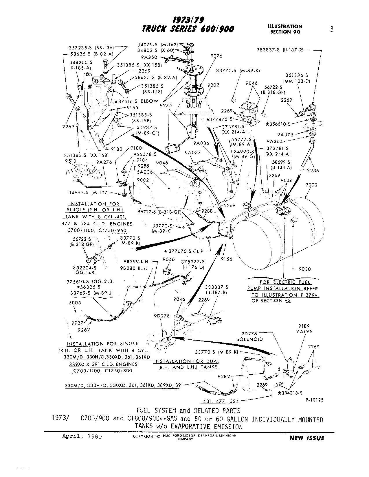

Old Oct 25, 2017 | 10:10 AM
NumberDummy's Avatar
NumberDummy
Ford Parts Specialist
Posts: 88,826
Likes: 784
From: Simi Valley, CA
