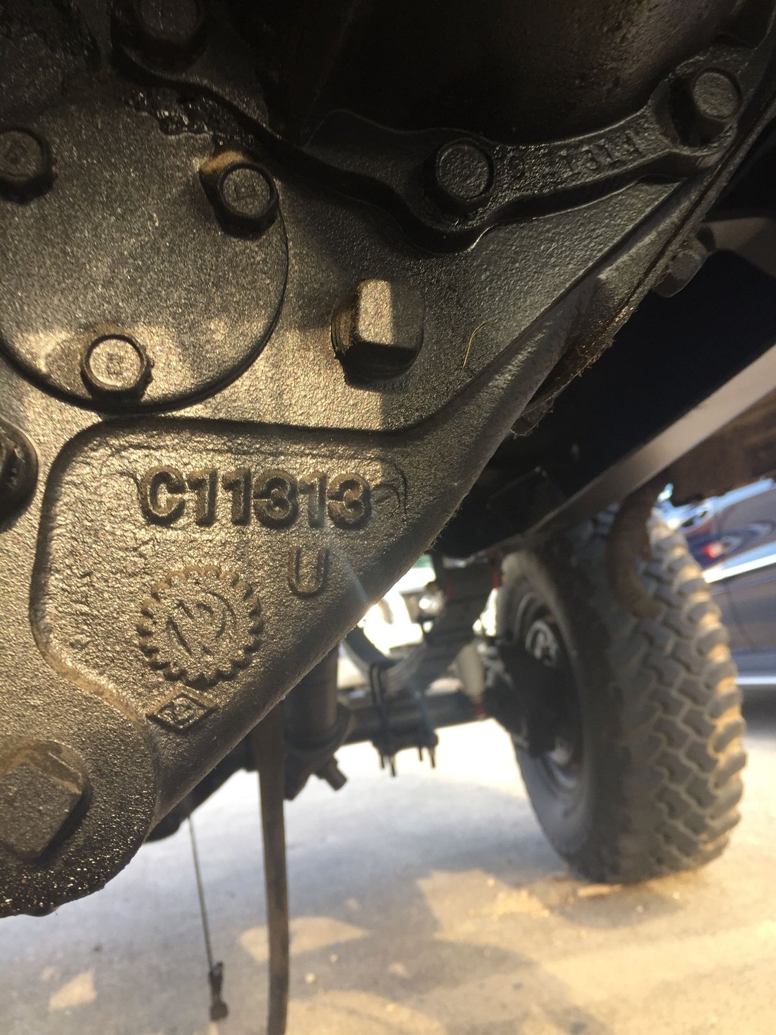

I stopped by today to take some pictures for a couple of buddies and to answer some of the questions I have. It seems to be factory 4x4 with larger axels and gear box than my 77 high boy, but this is also a much bigger truck. Cabs in good shape and the two spots in floor board that are rusted will be pretty easy repairs. Most of the cancer is around the top of the cab and one spot around back of cab. It also seems to have had cruise control. Those are gas caps at the bottom of fenders and there were three tanks on this truck and pipped together for long distance driving or for less trips to the gas station. What's one more ford truck project. The motor is fresh rebuild and waiting to find engine specs. Tranny is overhauled and has new converter. Still haven't seen the bed but think I am gonna go ahead and get her. The frame work is done and now it's body work paint and motor.

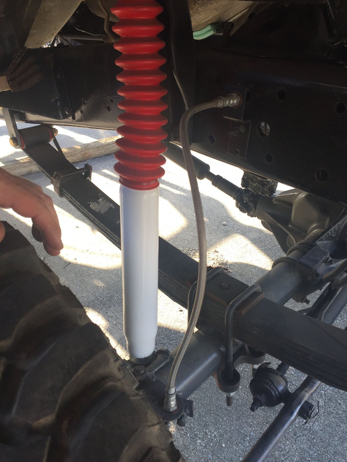

Passenger front new brake line

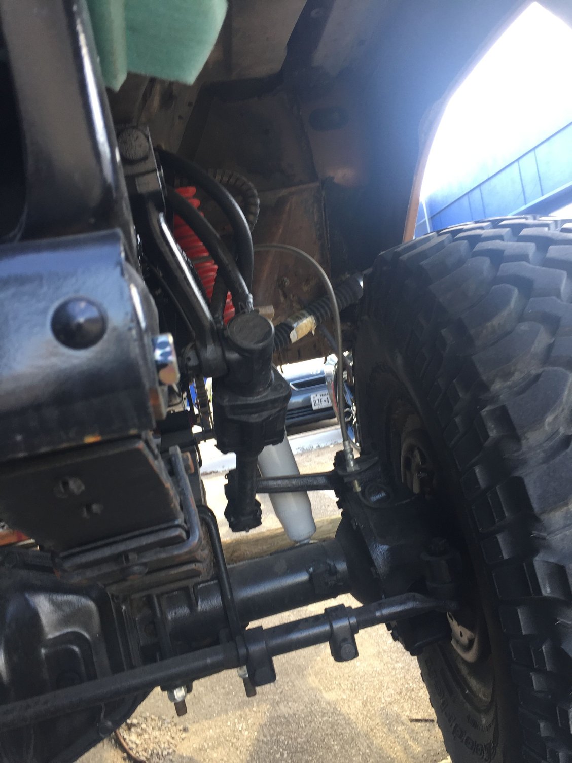

It's a different type of steering than the gear boxes I am used too.

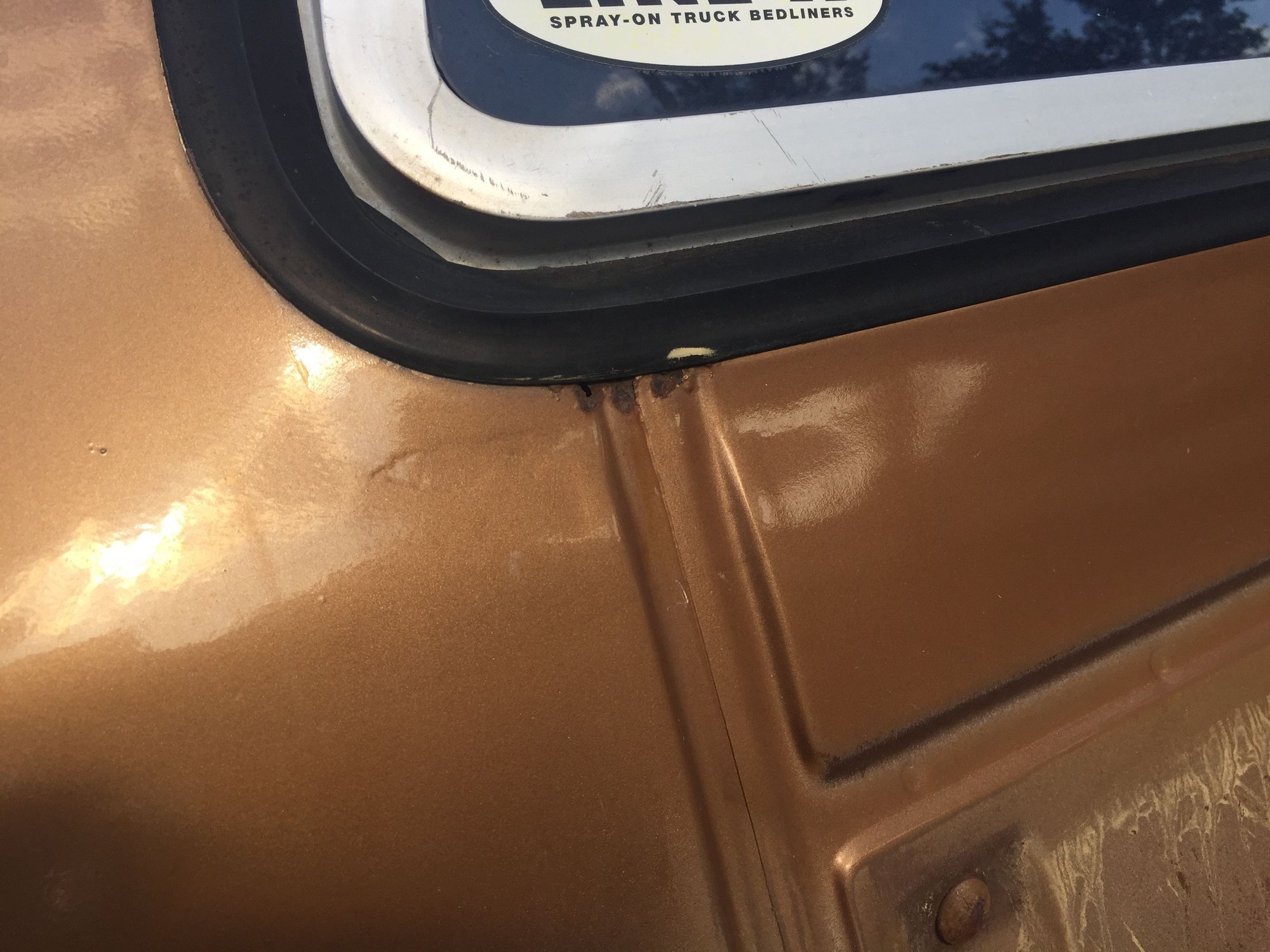

Rust under back window

This is the number of transfer case. The metal tage is unreadable.

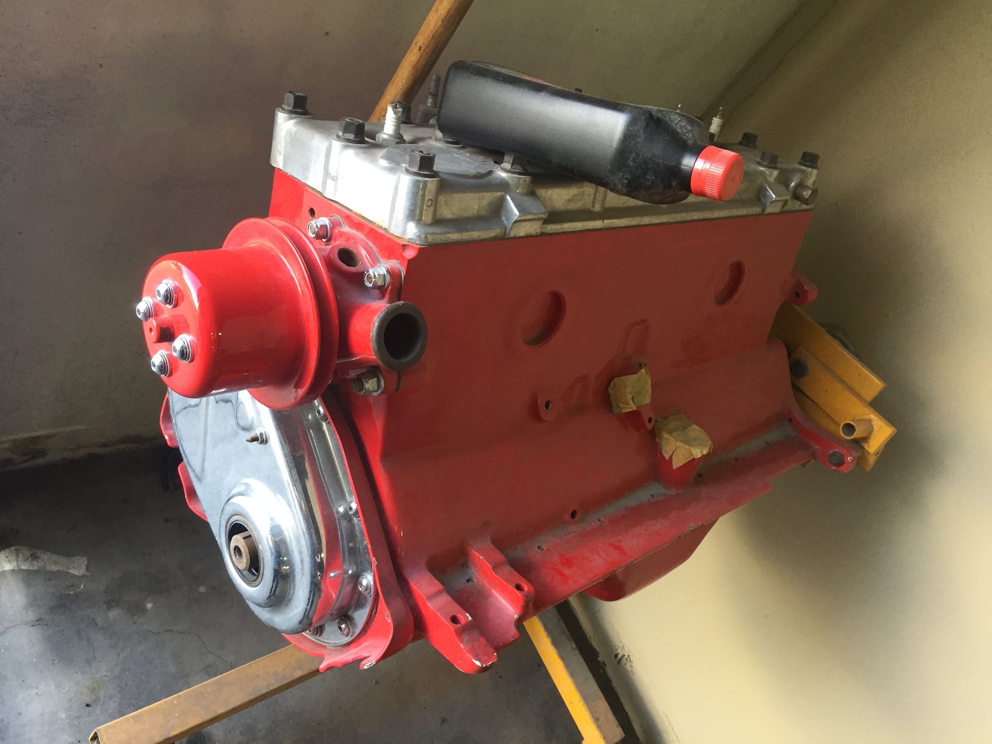

Found this in the corner and just wanted to share and see who knows what it is.

Garretson or Bendix power assist steering set up.

What is the xfer case shift pattern? In that pic it looks like a NP-203 with the large output are? You can see the NP (New-Process) inside the gear ring on the housing below the #'s.

Looks like a flathead inline engine, but I can't tell how many cylinders. At first I thought four, but now I think it's eight. Looks like the timing pointer is on the bottom, or is that it coming out of the timing cover. Someone here knows.

Just looking through these pics again, that front axle has drum brakes. I'm thinking its an M715 front axle. Especially with those closed knuckles.
