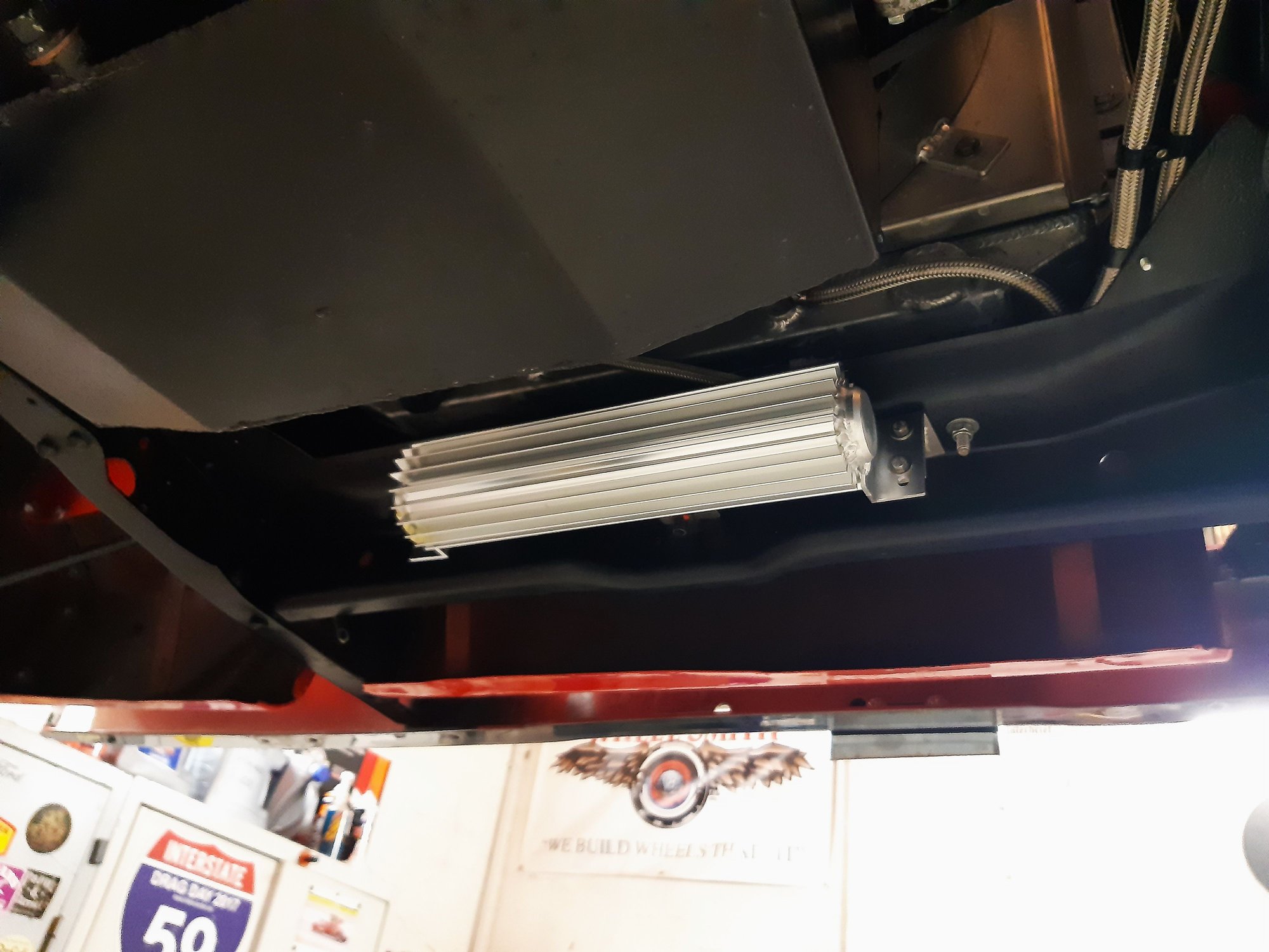

In the meantime i got such a cooler and fabricated some brackets, now i have to purchase some Hose...
but since we got snow last night it will take some time until i can test it...

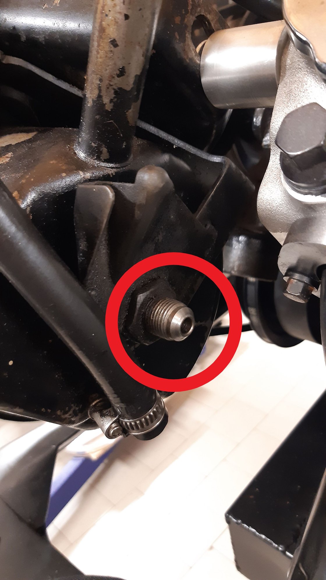

Since I will need a new hose can anyone tell me which connection I need for this pump? As I am about to convert to hydroboost, I need a new connection for the Hose to the servo pump, but I don't know the name of the thread and the seal seat.
Can the connection on the hexagon be loosened from the pump? Which thread is behind it?

It looks like a standard JIC (37degree) fitting. If you can get a tool down the to measure the angle that would confirm it. The other option woud be that it is an AN fitting, but IIRC none of those were AN.

OK i had a chance to test AN, it is too little for AN8 and it ist too big for AN6, so it is not an AN fitting.
It seems to be an 5/8-18 JIC fitting, but i can´t find a connector to this fitting.
