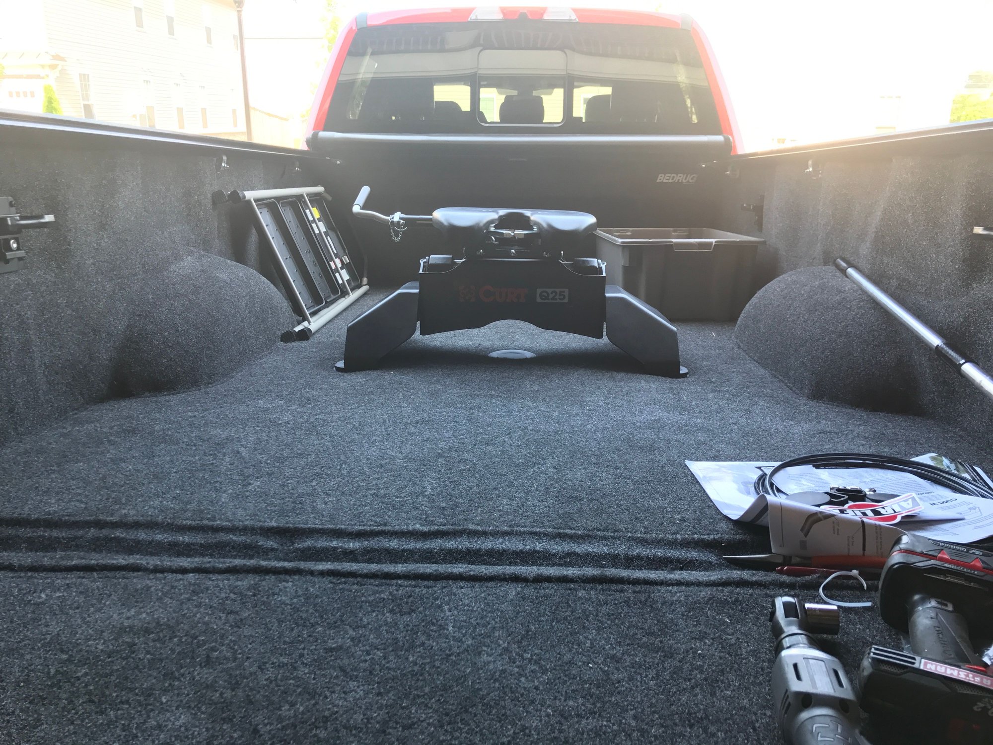

Etrailer has 3 options
I have the same truck and just put a 24k rated hitch in mine. Ordered from etrailer. Took about a week to arrive. Debated between this one and factory one in the end the lower price of the curt hitch won out.

A little of track, but did the bed rug come with holes cut out for the hitch pucks & lights, or outlines to cut them out?

You have to cut out holes for everything on the bed rug. Its very simple and easy.

Bedrug had outlines for the lights, but those are so close the end of the bed you don't need them. No the puck holes were not marked on mine. It just took a bit time feel my way around and cut the holes. The harder part was getting the trim rings bend and fit over the mat. I recommend heating them up in sun on a warm day to help make them flexible enough to bend easy. The end result I think was worth the extra effort.

Nice set up...are you at the highest setting for height adjustment? I had to go to the highest on mine to get ample bed rail clearance. I've got the Curt Q20 though with the regular mounting rails.
