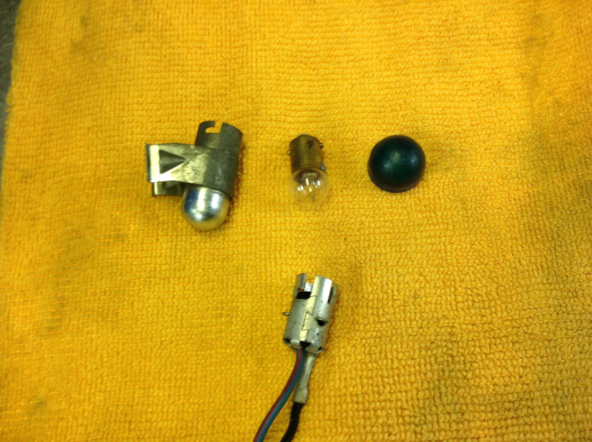

Found this lamp assembly as part of the 79 dash wiring harness I am refurbishing. Where does it go and what does it illuminate?

That goes to the left side for the headlight and wiper switch, just clips on to the plastic surround.

X2 on yes it is the back lighting for the headlight and wiper switch legend lens. The metal clip/bulb holder clips into a bonded plastic piece on the back side of the instrument cluster bezel.
The piece that the metal clips has been known to break off.
