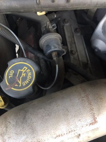

Well I found a leaking CAC hose at the turbo. I replaced both the top and bottom hoses as well as the drive belt. Temps seem to be normal now but I'm not sure if the hose was my problem all along.
Gray line going into AC hose from the firewall to the ac compressor.
I found this cable disconnected from the AC line as well. I drove my truck yesterday in 102 temp outside, temp ran at 202 then back down to 191 when I got home. I'll continue to monitor on my next trip to AZ next month and report back any changes.

The grey vacuum line is connected to the heater core coolant valve. When vacuum is applied it draws in and closes the valve so that hot coolant is not flowing through the core. This makes the HVAC more effecient for the AC by lowering the air temp in the box.
